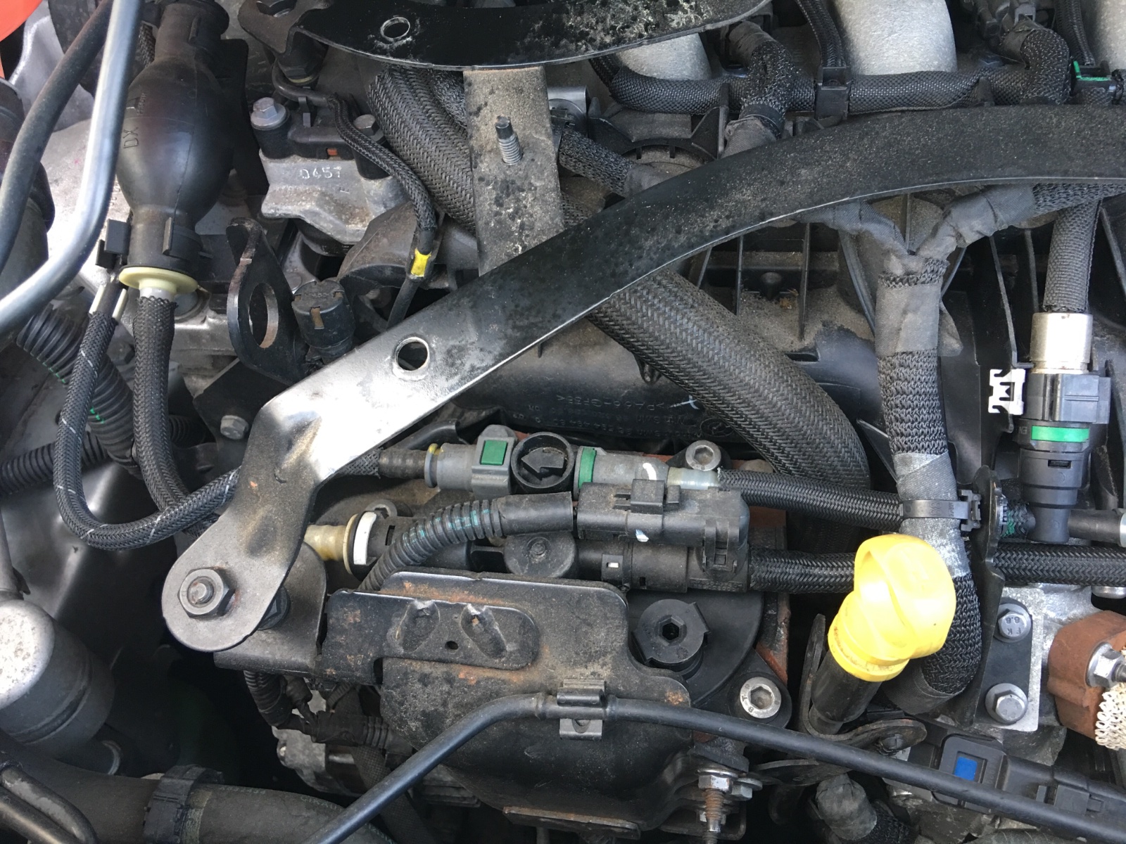

My C8 mk2 2.2HDi won’t start. I was running low on fuel... but the range still said 20miles... and the car coughed to a halt.
Clearly the range was wrong and I ran out! :-(
I have filled up from a jerry can but now need to prime the system because the engine won’t start.
How do I do it??
There is what looks like a manual pump to the left of the fuel filter. I pumped that until it had what felt like decent pressure and tried to restart... but nothing. It won’t start.
And ideas anyone?
I have searched the forums but can’t find the answer... and I’m sitting by the side f the road as I write this...
Thanks very much in advance for any advice.

Give me a second and I'll just look it up for you! I'll need VIN or can you tell me do you have the 2.2 136 or 2.2 175?

When I ran out of diesel in my 2.0HDi Berlingo some time ago, it took pumping the bulb until it was hard, and a *lot* of churning on the starter to get it to start again, a right pain in the bum.

I've just checked what I had and there are no special instructions, except to prime using the manual 'bulb' pump. However, you may have a lot of air in the system and that may take some time to start. Also, son't keep trying to start the engine too many times, or the injection may put the car into anti-scanning mode if you attempt to try and start the car too many times in succession. If this happens, just keep pumping the primer whilst leaving the car, then try and start it after a couple of minutes.

I have tried continuing to pump the bulb... waiting and then trying to start... but no luck unfortunately. :-(

Thanks all - I have finally got it going! Lots and lots of very hard frustrated pumps... waiting then doing the same again got it going!
