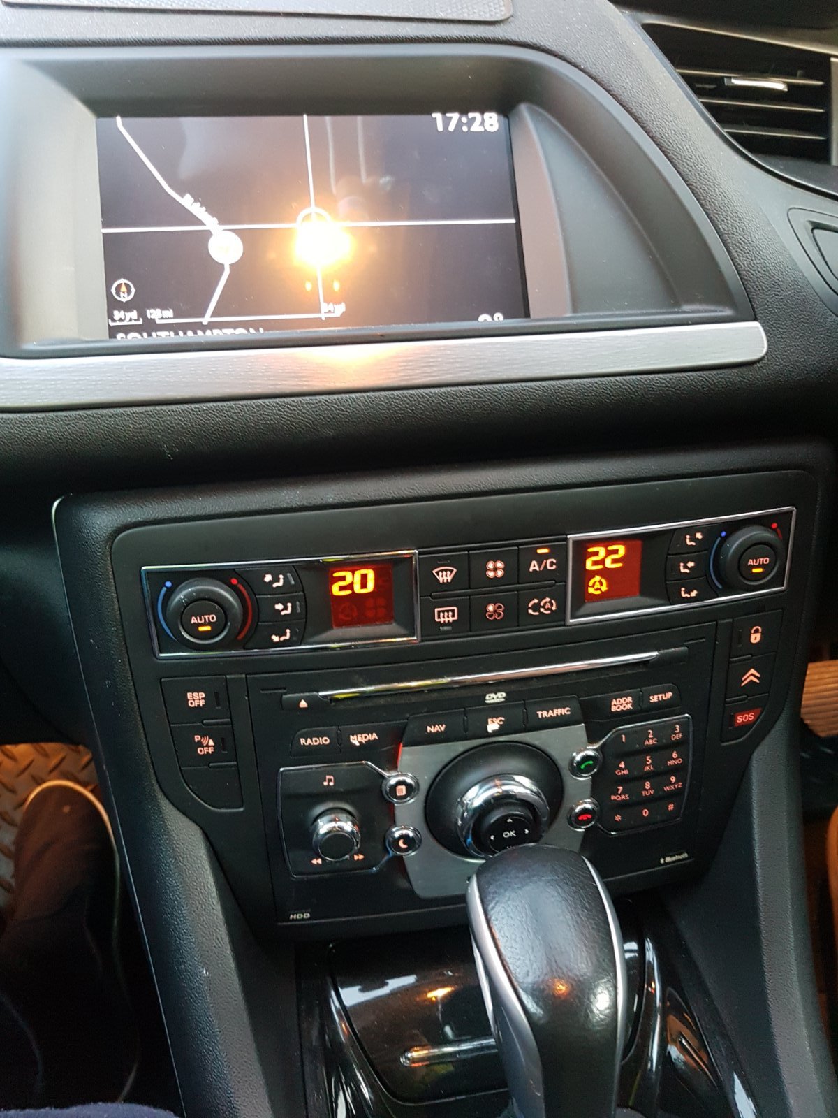

Now is a live. I bay a new display from aliexpress and everything now is ok. But the GPS not working. I can't understand why.
Reason: Image rotated

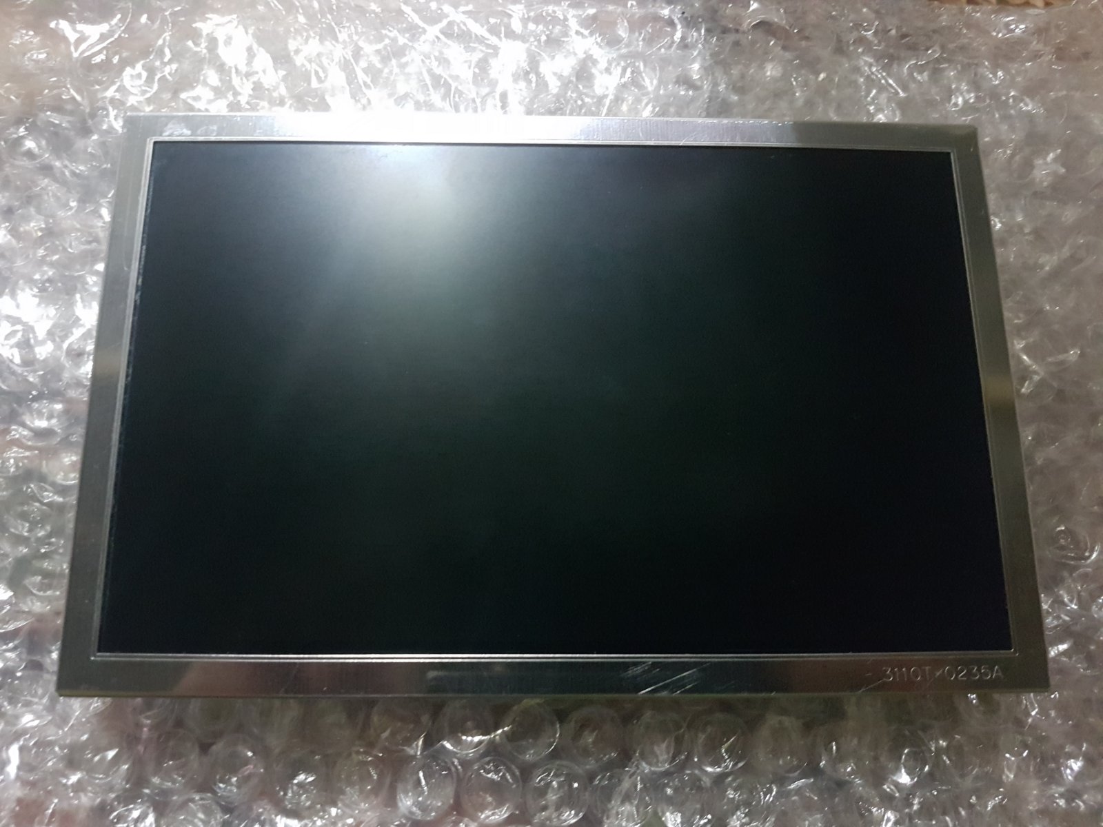

Hi. I bay only this module ?66.42 | 7inch lcd display LB070WV1 TD04 LB070WV1(TD)(04) LB070WV1-TD04 LCD Screen Module for Mercedes Car Navigation Audio
https://s.click.aliexpress.com/e/iBnUU7J
But the price was 34.28£ and everything was 50£ with delivery. Now I need to change the display frame. My frame is 154x88, I need 154x93,5.
- x 6946
Re: RT4 to NG4
What you have to remember is that the Mutli Function Display also contains an ECU and therefore the system won't work fully with any display Martin. It needs to be the DG4 display.
