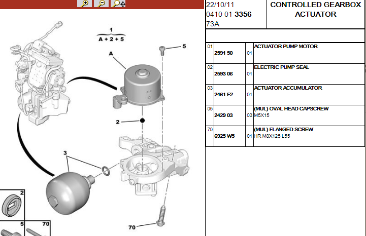

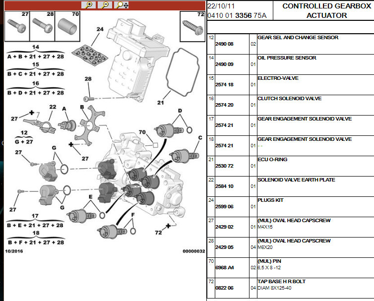

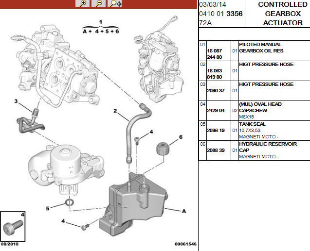

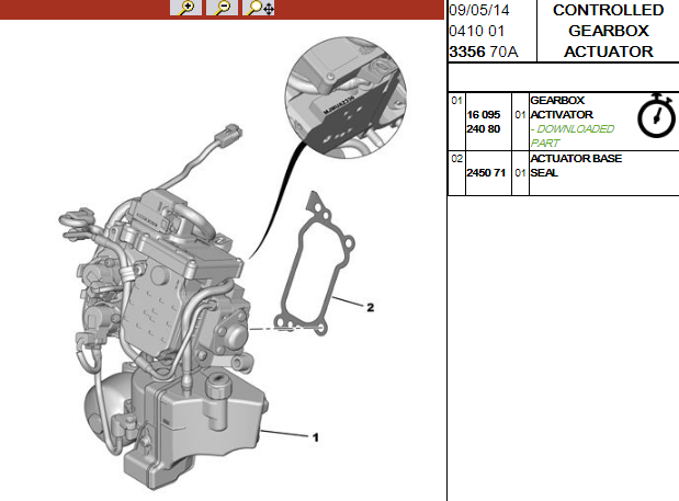

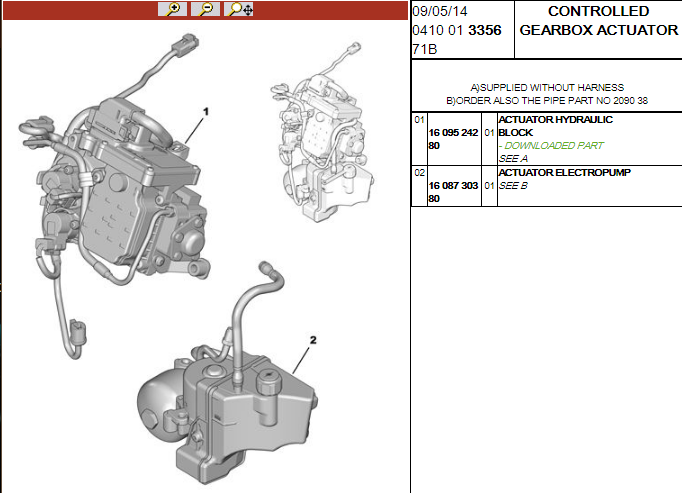

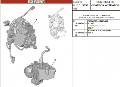

As there are quite a few components and Idon't know specifically what part your friend would be after, I've just put the lot up here in a table as far as the Gearbox Actuator goes. Just click to zoom these up.
So the Berlingo is a Stop Start model:
BERLINGO PRIVATE VEHICLE (B9) FAMILY SALOON 1.6 HDi 92 (DV6DTED) piloted manual gearbox 6 (With stop and start)
