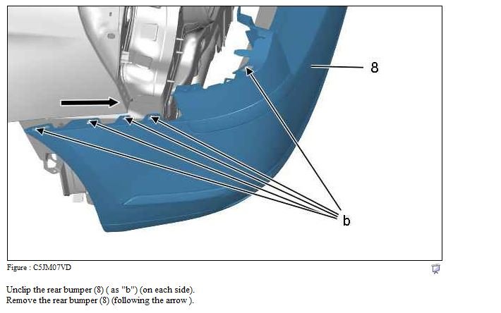

When you've removed the light clusters aren't there some screws visible to take out? Also there are five clips holding the bumper onto the wing on each side.

It certainly feels like there are clips holding the bumper to the wing but how do I disengage them?

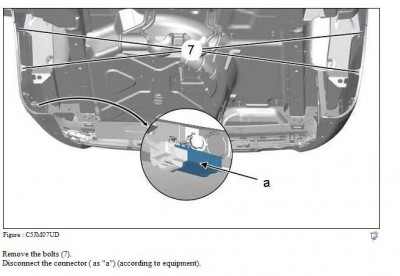

Yes, but how do I get to the stage shown in your first photograph?

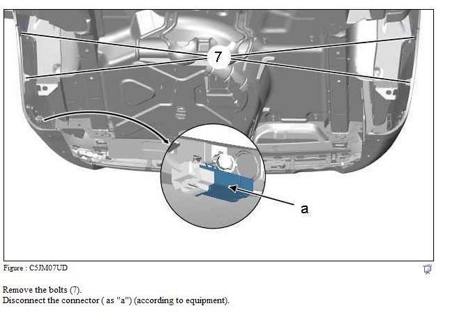

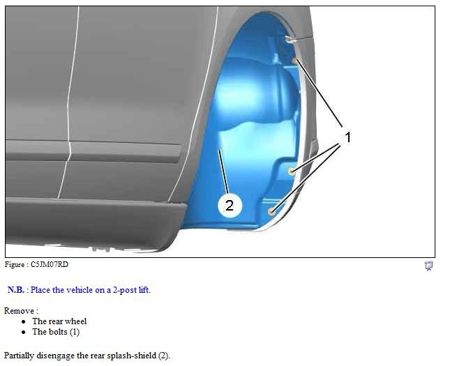

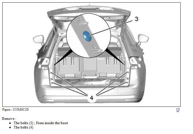

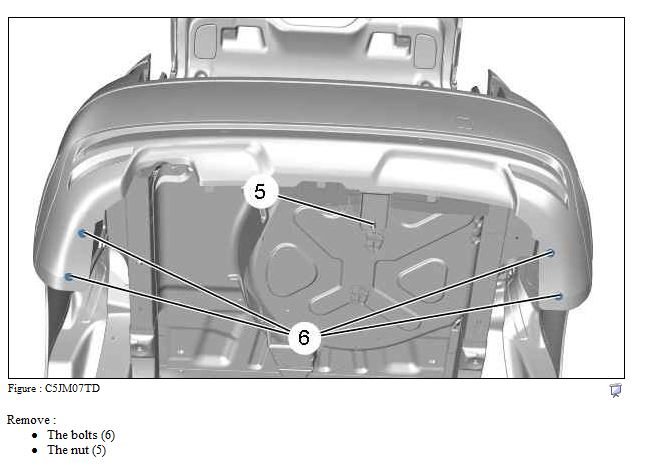

Re: X7 Tourer. Removig rear bumper to fit towbar (fail) - help please!
Richard has Posted this up earlier this morning - I would just add the refitting and tightening torques to this:
Proceed in the reverse order to removal.
Check all the equipment works.
- Tighten the bolts (3), (4) to 0,4 ± 0,1 m.daN.
- Tighten the bolts (7) to 0,2 ± 0,05 m.daN.

I used a very thin plastic trim removal tool to release the side clips....I put some masking tape on the wing edge/fold line to prevent any scratches.

Well, it's off. What a tw@t of a job to separate the bumper from the wing at the side. It IS just brute force that does although I did find that by "helping" the first clip, at the wheelarch, to disengage with a screwdriver this then gave a bit of extra purchase for the other two. I then had an idea that squirting some oil into the small gap might help the clips to let go. It was still a bugger though.
