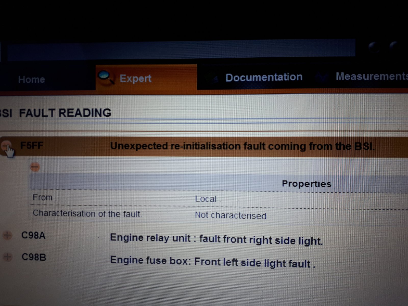

Got in it an hour later to take the ladies out, simply refused to start. There's a relay clicks and the fuel pump whirrs but that's it. Mr Hellrazor kindly dashed down with his Lexia and Diagbox gives a fault about Injection ECU incoherence.. and a BSI reinitiliasation error - pic attached.

Something else was that DiagBox reported a coherence fault with the Injection ECU, but when we went into that item and tried to read the fault it said something like no fault found. The Engine Management fuse (20A) was sound.

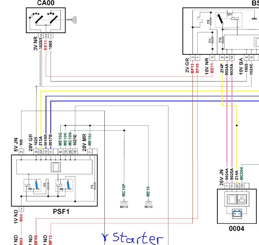

I don't understand all the interactions, but it seems reasonably straightforward....
Live to the ign switch is provided from F11 on the BSI, via pin 5 of a 10 position black connector. At crank position, this should supply live to pin 9 on the grey 28 position connector on the underbonnet fuse box (BSM) . This should pull in relay 8, which is fed off fuse 8 on the on the BSM, and the BSM should then put live on pin 2 on the 5 position yellow connector on the BSM which is connected direct to the starter. It's possible there are some BSI / BSM interactions, as the BSI also receives a 12V crank signal from the ign switch on pin 6 of a 10 position on the BSI (not sure on the colour, what French colour is BA an abbreviation for - white possibly, being blanc?). There's also a 12V feed back from the BSI to the BSM from pin 16 on a 16 way green connector (BSI) to pin 23 on the 28 way grey BSM.
I'd still go old school and give the starter a whack!
