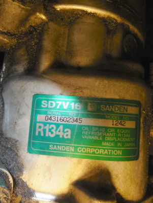

Having just looked up the pump details online type SD7V16 it says it is a refrigerant pump ?
This looks as though the car unknown to us has air conditioning : )
The steering pump then is the smaller one at the top visible while looking under the bonnet ?
I looked online and the compressor has oil in it
It never ceases to surprise me how much I do not know : )
Whether the leak is compressor oil or hydraulic fluid I shall have to check.

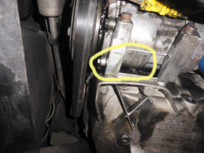

We have done about 100 miles since replacing the front height sensor and the seals on the rear driver side suspension ram.
Yesterday I spotted a small pool of fluid from the front drivers side.
Today I took the cover off under the engine compartment and cleaned all the dirt and fluid off round the mechanical pump that I think is for the power steering.
I then left the engine running while we chain sawed some logs : ).
No leak, I then turned the steering from one lock to the other and some drops appeared from the bottom of the power steering pump.
The alternator is directly above the pump so I cannot see exactly where the fluid is coming from.
I took a lot of pictures but the most relevant ones after cleaning all the dirt off are attached.
Have any of you most knowledgeable gentlemen had a similar problem ?
If not I shall have to take the alternator off to see the top of the suspension pump.
Going by the wet look of the dirt something round the pump or the pump has been weeping for some time.

That's the air conditioning pump. All c5's have air con (even the base LX).
That pump is unlikely to be leaking any fluid (the system basically has only gas in it) so if there's something leaking from that, it's more likely dripped onto it from above, first. My guess would be an oil leak from something on that side of the engine near the top (Cam cover etc) or just where someone made a mess topping up the oil.
Take the cover off the top of the engine and see what you can see.
If you haven't had the cover off before, twist the four black caps through 90^ and then pull them off, then you can lift the engine cover off. The engine cover sits on top of four rubber posts that screw into the top of the engine. Given the age of your car, you'll probably find that when you twist the caps instead of the cap twisted as its meant to, the rubber post shears off (the bottom of the post is bonded to a screw that bolts into the top of engine). They're cheap to replace though.

Good morning Ian, Thank you for your reply.
The top engine cover is missing which does not surprise me : )
I had the bottom cover off a couple of months back when I checked the auto gear box oil level.
At that time I cleaned the bottom cover both sides before replacing it, this leak has happened since then as the dripping was spilling over the drivers side of the tray.
I did top up the suspension fluid after the repair to the rear suspension ram, I do not recall spilling any and the tank is I think too far over to be the cause.
There is oil in the compressor as it had a recommended type on its label sp10, a bit like a fridge compressor I suppose it runs in oil.
Air conditioning that sounds really posh : )
MOT is due next month so have to sort it out in case it is hydraulic fluid, I was not sure smelling it but then it was freezing out there : )

If it is the air con compressor, don't worry. You can eliminate it by fitting a shorter belt, rather than cough up to keep air con. Check it out for oil leaks above once weather fairs.

Spiff, that R134a is the refrigerant to be used in this compressor. When it is re-gassed properly using a machine, they usually add a quantity of oil to the system as well.

Thank you Lexi and Marc for your advice.
The oil that is coming out looks a normal oil colour, similar to the replacement fluid I topped the suspension tank up with.
No idea what the oil in the compressor would look like.
I am not sure if it smells the same, I shall have to sample them side by side, could be my nose is suffering from old age. : )
It is close to zero and snowing hard so I think I will leave it for today.
As soon as it clears I will have a good clean round the steering pump, then fit some card or something similar round and under it to see if it is the culprit.
Marc as we are looking for a younger low mileage C5 if it is the AC compressor I will bypass it as suggested, it is not worth a new compressor and re-gassing, but good knowledge to have for the next C5 : )

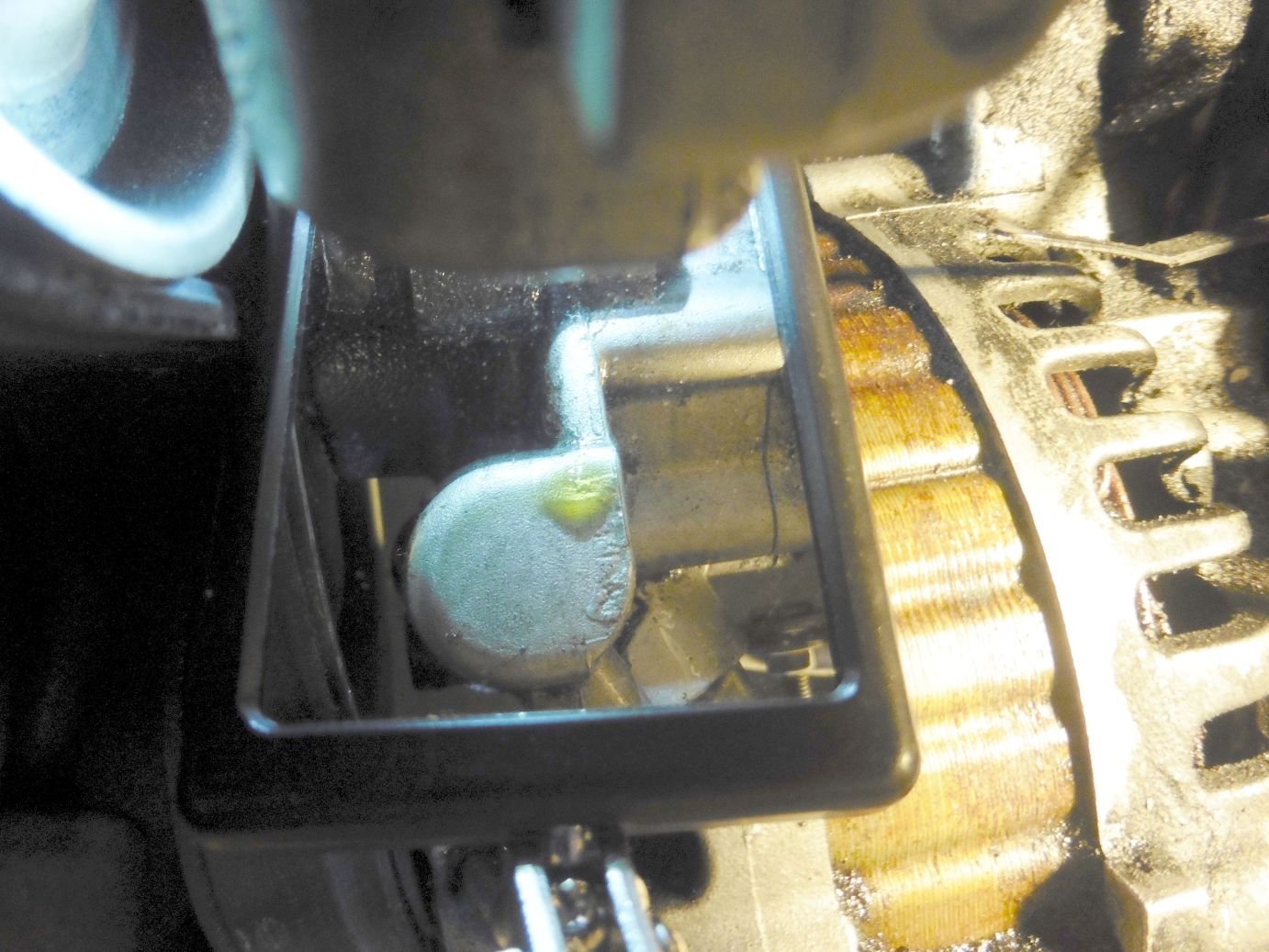

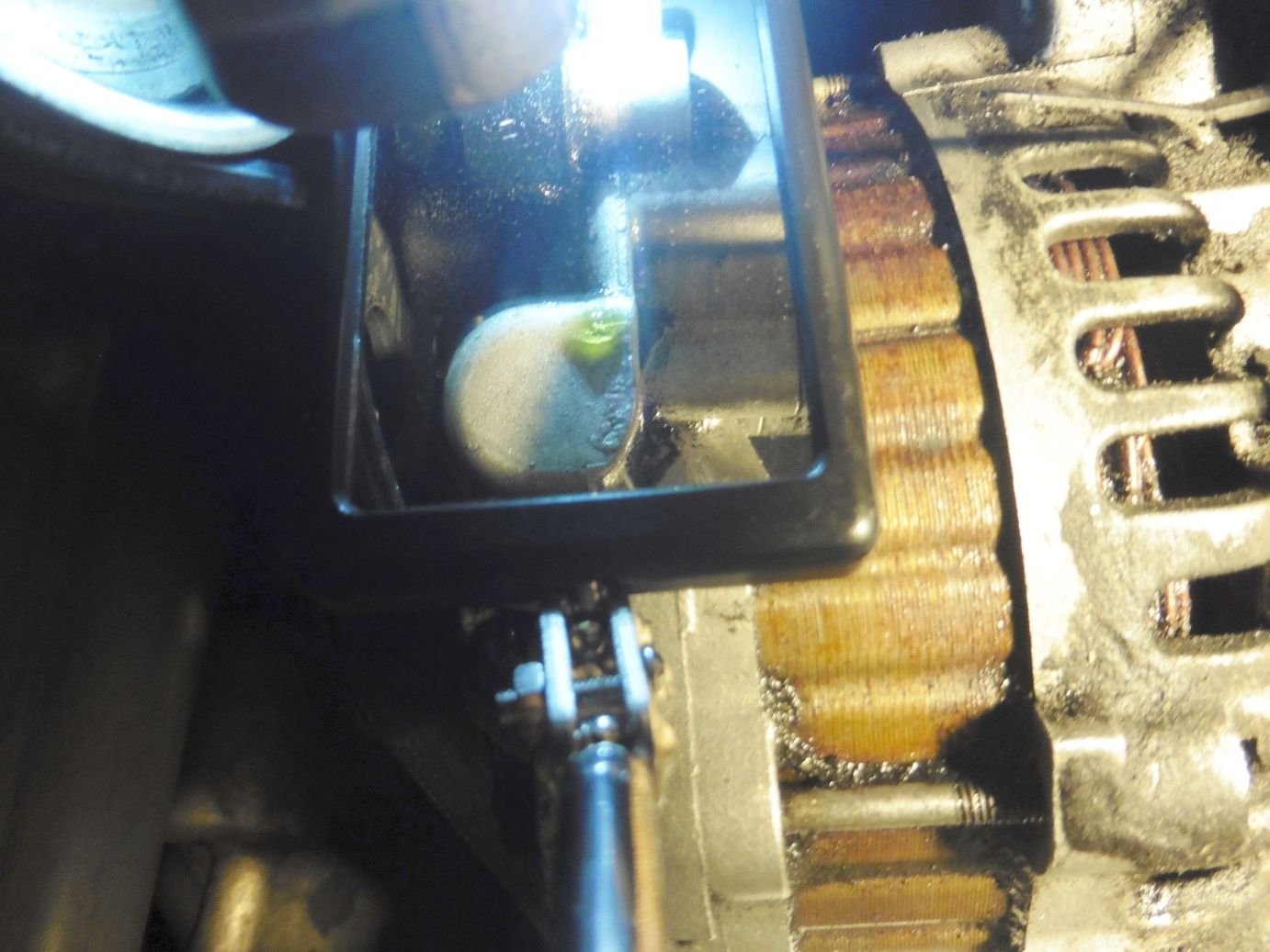

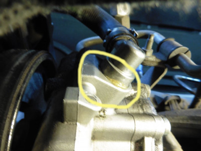

The snow has stopped so I had another look with a mirror on a stick, it has a nice bright built in LED.
It shows under the steering pump it looks to be the source, but exactly where on the pump it is coming from I am not sure.
There is a lot more fluid around apart from the drip, but it does not show up in the image very well.
The alternator has always looked as though oil has been leaking on it, way before the puddle appeared.
It could be it has been leaking for some time and just got a lot worse : )
The top of the pump is dry.
Is anything fixable on the pumps I wonder ?
There are some cheap used ones on eBay : )
God Bless Spiff

Another day in the cold : )

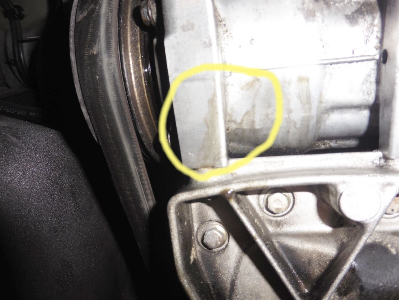

The leak is from the join shown circled in the image, it keeps seeping out even with the engine off as can be seen just after cleaning it off.
I have ruffed it up and applied Araldite, you never know : )

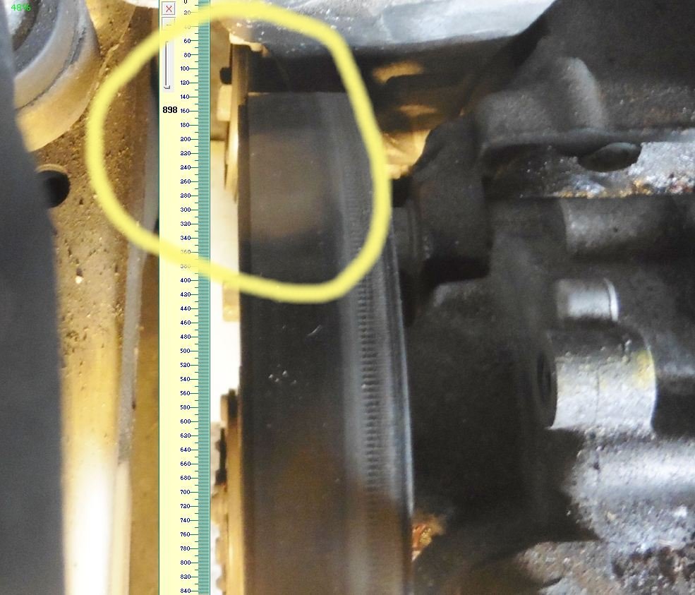

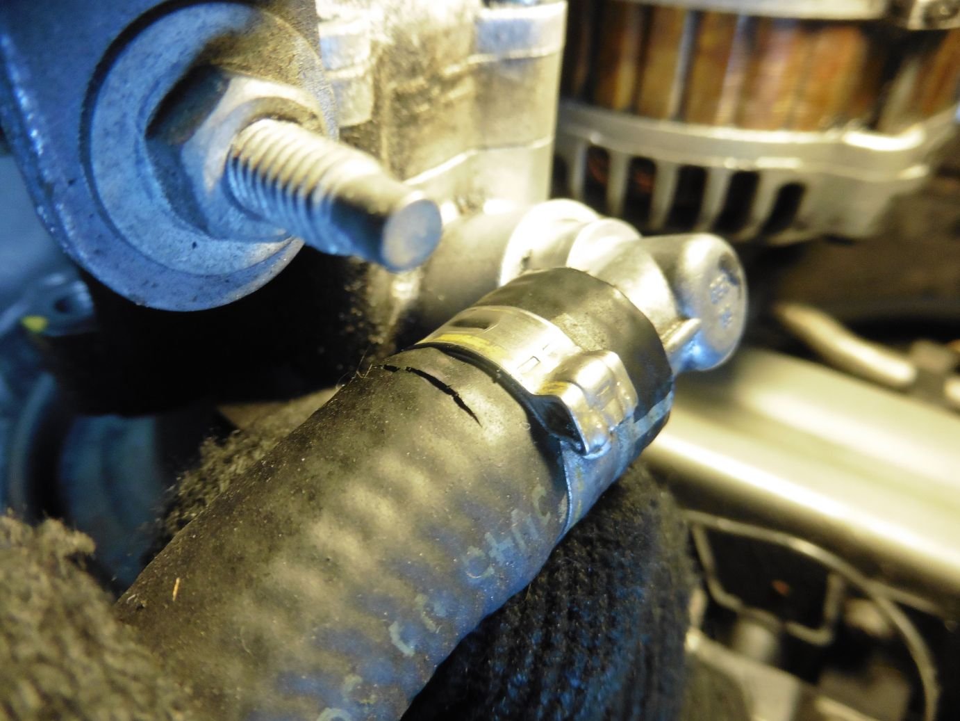

Other faults have shown up one being the alignment of a pulley please see image and a split in a rubber pipe feeding the pump.

Yesterday I used Araldite but there was pressure in the system.
Today I chipped it off then released the pressure cap and knocked the metal in round the leak, then applied some fresh Araldite.
