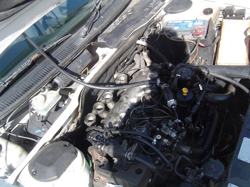

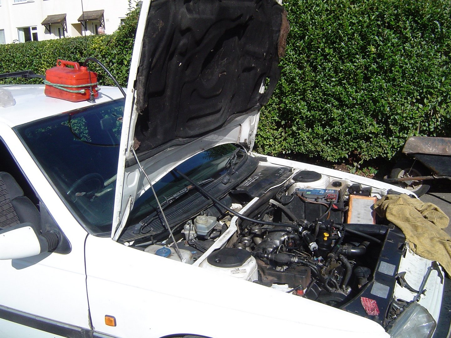

daviemck2006 wrote: 13 Mar 2018, 22:36 And the price of pumps on eBay is why I am further investigating my fuel leak as Im not convinced that it is my pump that is leaking.
Try doing this, I had a nightmare with a fuel leak... [and I mean, nightmare!]. My 'turning point' was realising it'd run from a can just fine.
I put it on the roof first, for gravity feed
then I put it on the floor
then I found a chaffed fuel pipe, close to where it goes from the tank to the pipework inside the cill
Cost me £400 for a garage not to fix that, + £12 for the pipe. The whole sorry saga is documented here on FCF, October 2016.

Re: Bosch Injection pump rebuild info request
Now, there's an intelligent suggestion.
A couple of banjos, some pipe and a can of clean diesel, sat on the roof.
Eliminate all the car's own plumbing and lightly pressurise the feed and return, thanks to gravity, so any leaks will be fuel rather than air.
Might just solve my problem, reported in my thread!
