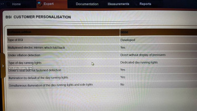

Sorry if this was discussed before, I have lexia for some time, I activated and deactivated some options but I can't find how to activate the option for daylight in car's menu.

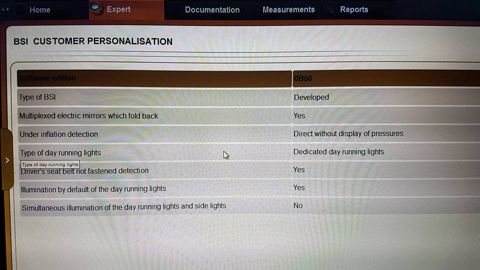

I had the option but I don't know how it disappeared. I have attached 2 pictures with the settings from BSI..I have tried all these but without result. Any advice is welcome.

So what version of Diagbox are you running?
After enabling DRL in Diagbox, have you disconnected Diagbox, switched off ignition, locked car and waited 5 minutes, then start car, go to configuration menu on steering wheel (left scroll wheel button), check lighting menu for DRL option.
If it is still not available, go back into Diagbox, back into the personalisation menu and disable Dedicated DRLs, allow configuration to write, come out of Diagbox and switch off car, wait for BSI to sleep, then try re-enabling again.
Sometimes it can take 3-4 attempts to get the menu to activate in the dashboard to show the DRl option - and this was also not helped by one of the software versions of Diagbox that had a telecoding issue on the X7 (hence why I asked the version you have).
Try the above and let us know.

OK, one thing to be aware of - sometimes (as happened to me), the option would appear, but the driver welcome function would disappear, then when I got that back the other would go! So I found that I had to get three options correct - the central locking of the plip (all Doors or Driver door only, the Welcome Function and the DRL Function). I had to check and activate / deactivate these three until I got them all working (keep checking the menu after telecoding to see if the options have changed). I think it is a glitch, but with patience I got mine working fine with all options as they should be. Also the function of the Electric Parking Brake - enabling this to be switched from manual to automatic is a function that can disappear when configuring other things - so check that out too.

I finally succeeded after: I disabled the parking sensors view on dashboard screen, I activated the gear recommendation indicator and I disabled Dedicated DRL. I don't know if the first two options have to do with the option for DRL but I will try to activate one by one.
