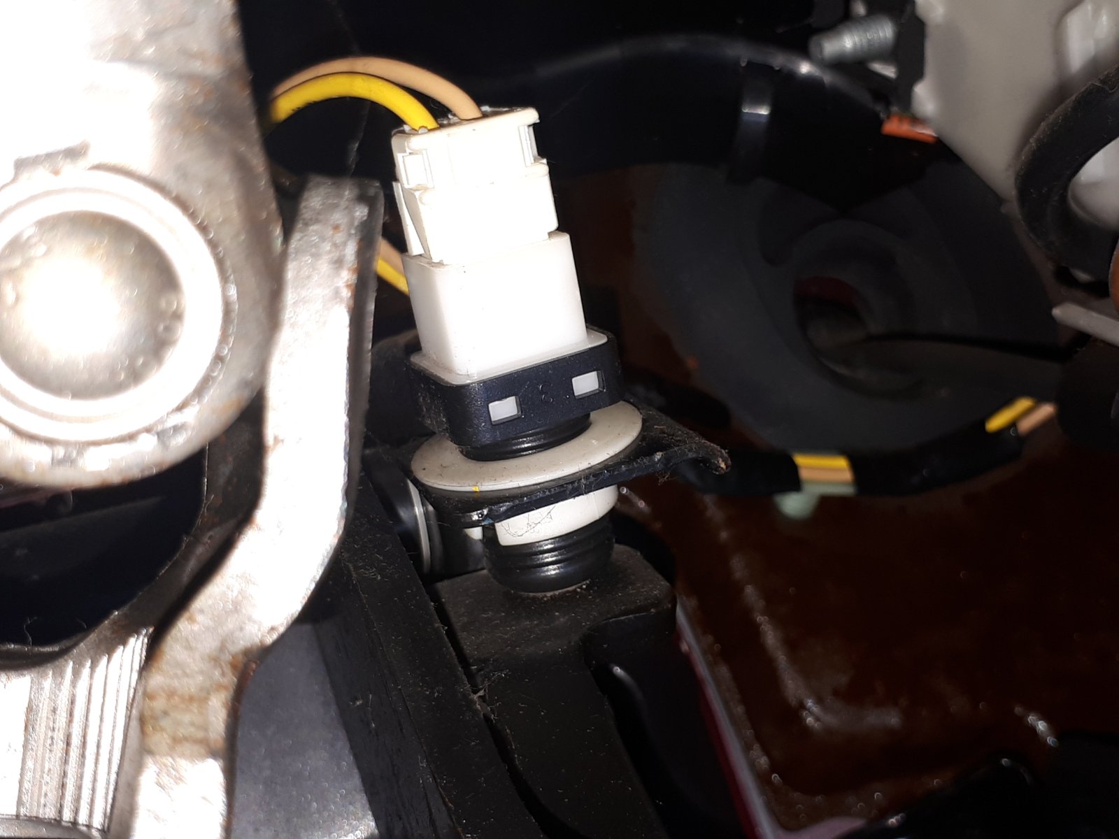

Would one bulb blown cause both cluster and 3rd light to fail?
I've also added a pic of the brake switch just incase
x 2938
Re: Xsara no brake lights at all!!
To eliminate the switch simply disconnect the plug and join the two together pins in the wires together, a paperclip is all you need and if the lights come on with the ignition on it's the switch that's faulty, if not you need to look elsewhere.

Paperclip trick worked. What's the process for removing the old switch? Just pull out? Thanks
