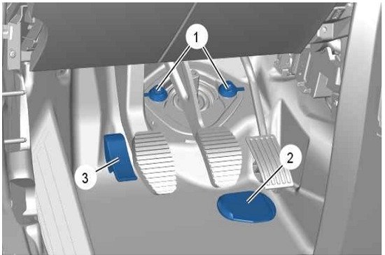

James - please be aware that the rust isn't necessarily on the fluid pipes - it starts on the main pinion below. The only way you can really see and get to it is via the driver's side footwell recess where the steering column exits the cabin floor. You need to remove the cover (1) in the picture and then you can see the condition of the pinion.

Re: C5 x7 hydraulic stop leak
Yes that is the pinion that turns teeth on the inner rack by way of a gear. The inside has bushings and seals. Turning the rack one way or the other allows the fluid to push against a dividing part and so provides the assistance in the desired direction.
Some designs are far better encased around the pinion to better protect from water and the elements - unlike this one! The issue here it that water 'sits' around the bottom of the pinion where it enters the seal and the water eventually starts corroding the pinion and then the rust starts breaking the seals down and enters the inside and starts doing the same to the inner seals.
