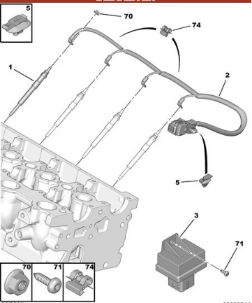

Please tell me why do the glow plugs appear to be at the back of the engine and not the front like normal vans?
How are you supposed to change them?
I do have a defective one and want to change them. please help.

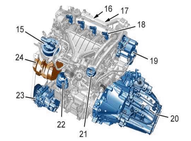

He has the 2.0 HDi 120 (DW10UTED4) in a Dispatch III SP Van H1 Type 12
The Turbo is at the back (number 17)

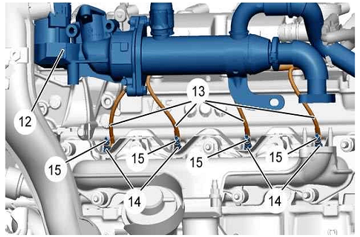

thats right, thanks marc. they are a nightmare! down the bloody back. can only just see them from underneath when on ramps. its a full arms Utrecht with next to no room. plus i think you need to take off all the egr assembly as it is positioned over the top of the plugs and u have no access ..
- x 6957
Re: citroen dispatch 2.ol hdi 2007 mk2?
No problems chaps - that's the same as the C5 with the DW10BTED4 - it needs EGR exchanger and the EGR Solenoid Valve removing to get to them!
