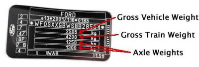

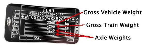

Have you actually referenced your car's VIN plate - as they're the only weight limits that matter.
A guide on how to interpret it is here:
http://www.carradiosdorchester.co.uk/to ... ights.html
Showing this image as a guide:

Thank you for the info, I just find it puzzling that above car has a tow limit according to the vin plate weights limits as a 1000kg
According to Citroen customer services who I rang is 1300kg, both seem low compared to kerb weight etc, same model cars a year either side is much higher, thanks in advance , Stu
