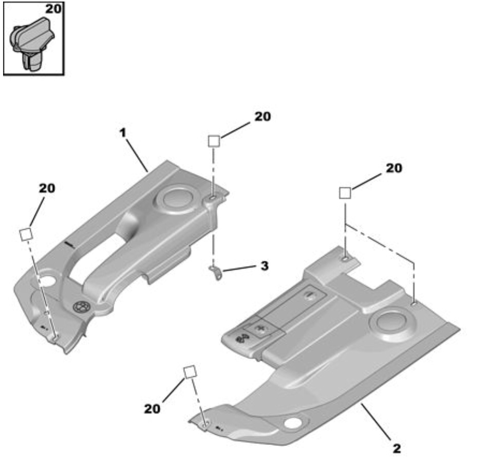

To save me mucking up again, can you tell me the part no./cost for the clips to hold on the panel covering the panel and the water bottle?
- x 6950
Re: Engine Mount Replacement
Can you be a bit more specific (“panel covering panel”) and which water bottle (screen wash bottle, expansion tank?)
I will need a VIN as there are different ones depending on engine type (PM it if you don’t want to post it)
- x 6950
Ok so if I understand this correctly, you need the hog ring clips, number 20 for the decorative engine side covers.
These are part number 715909 and are 25p each inc. VAT.
