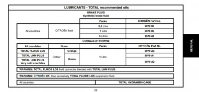

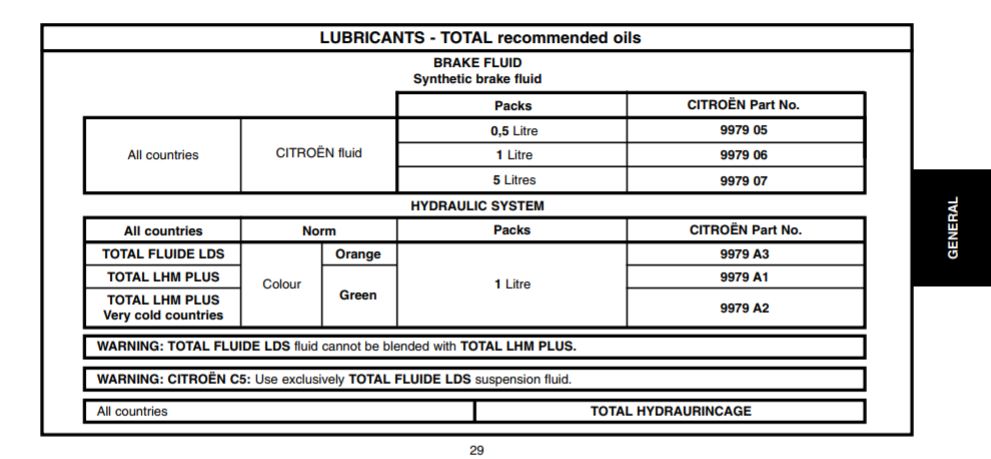

Is Hydraurincage compatible with the LDS system? Obviously it was in the LHM system, but I thought the two fluids were quite different.
- x 6950
Re: C5x7 Strut failure information from Germany
They are completely different fluids and mustn't be mixed.
I can't say I've seen anything to suggest Hydraurincage is safe to use in LDS-based systems - not even Total's own documents suggest using it on LDS systems - so I wouldn't personally. As LDS is a 'synthetic' and not a 'mineral' based oil, it would seem to suggest that Hydraurincage should not be used in such systems.
Link: http://avto-oil.biz/en/products/total/G ... QUARTZ.pdf
See page 56-57 of the PDF:Special fluid for flushing of hydraulic systems recommended when sticking or contamination has occured in passenger car hydraulic systems filled with fluo green mineral hydraulic fluid (TOTAL LHM PLUS). Never use in systems using synthetic fluids like synthetic brake fluids. Handling instructions: drain the system as much as possible, fill the system with TOTAL HYDRAURINCAGE, drive the car with TOTAL HYDRAURINCAGE for at least 1,500 km but maximum 5,000 km, drain and refill with TOTAL LHM PLUS.
- x 1746
Well aware that LDS and LHM are not to be mixed.
Maybe this data page is ambiguous?
- x 6950
That reference was just in answer to James' query about not mixing them Chris
I would suggest that service document is definitely ambiguous Chris. This isn't the only example I've seen of this in PSA documents either.
I think it would be safe to suggest that Total, who make the stuff are correct in this case Chris and would therefore recommend against using Hydraurincage in LDS-based systems (C5 and C6 for the benefit of others).
- x 6950
I've also just checked with Service Citroen and in the Recommended Fluid section for the XM as an example it mentions Hydraurincage as a flushing fluid - exactly as per the document you referenced above Chris.
However there are no references to any flushing fluids at all for the C5 in any variations with LDS, so I think we have our answer.
