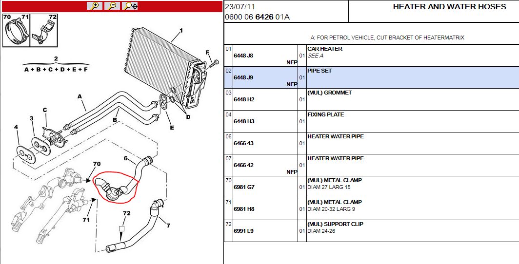

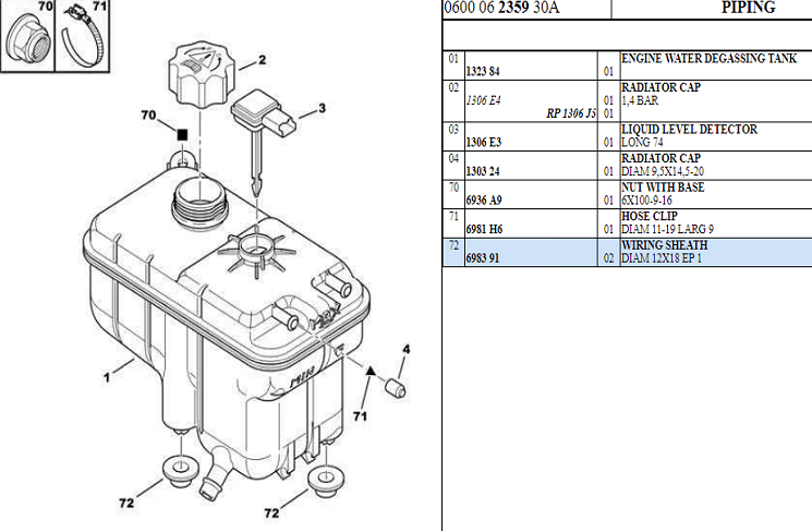

I've had a good look at the parts and Citroen refer to the degassing tank as part number (1) on the first diagram.
However, if you look on the last diagram, where I have arrowed in red this looks very much like the part in the photograph. Yet, I cannot see any reference to it as a part....
Click diagrams to zoom

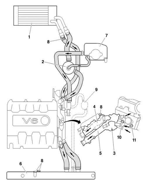

I've found a better diagram of the offending part - apparently they refer to it here as a 'Bubble Trap'. Unfortunately still no part number for it.
(1) heater matrix.
(2) Bubble trap.
(3) thermostat.
(4) Coolant outlet housing .
(5) Coolant inlet housing.
(6) Engine cooling radiator .
(7) Header tank.
(8) bleed screw(s) .
(9) Oil / water heat exchanger (automatic gearbox).
(10) Temperature sensor .
(11) temperature switch.
(2) Bubble trap.

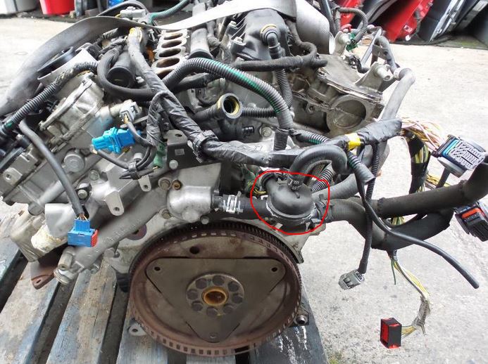

Gibbo2286 wrote: 12 Feb 2018, 10:19 Any chance this Renault one is the same?
https://www.ebay.ie/itm/RENAULT-5-GT-TU ... wBkRZ6I3M
This looks similar. I will contact local dealer to see if have i stock.
