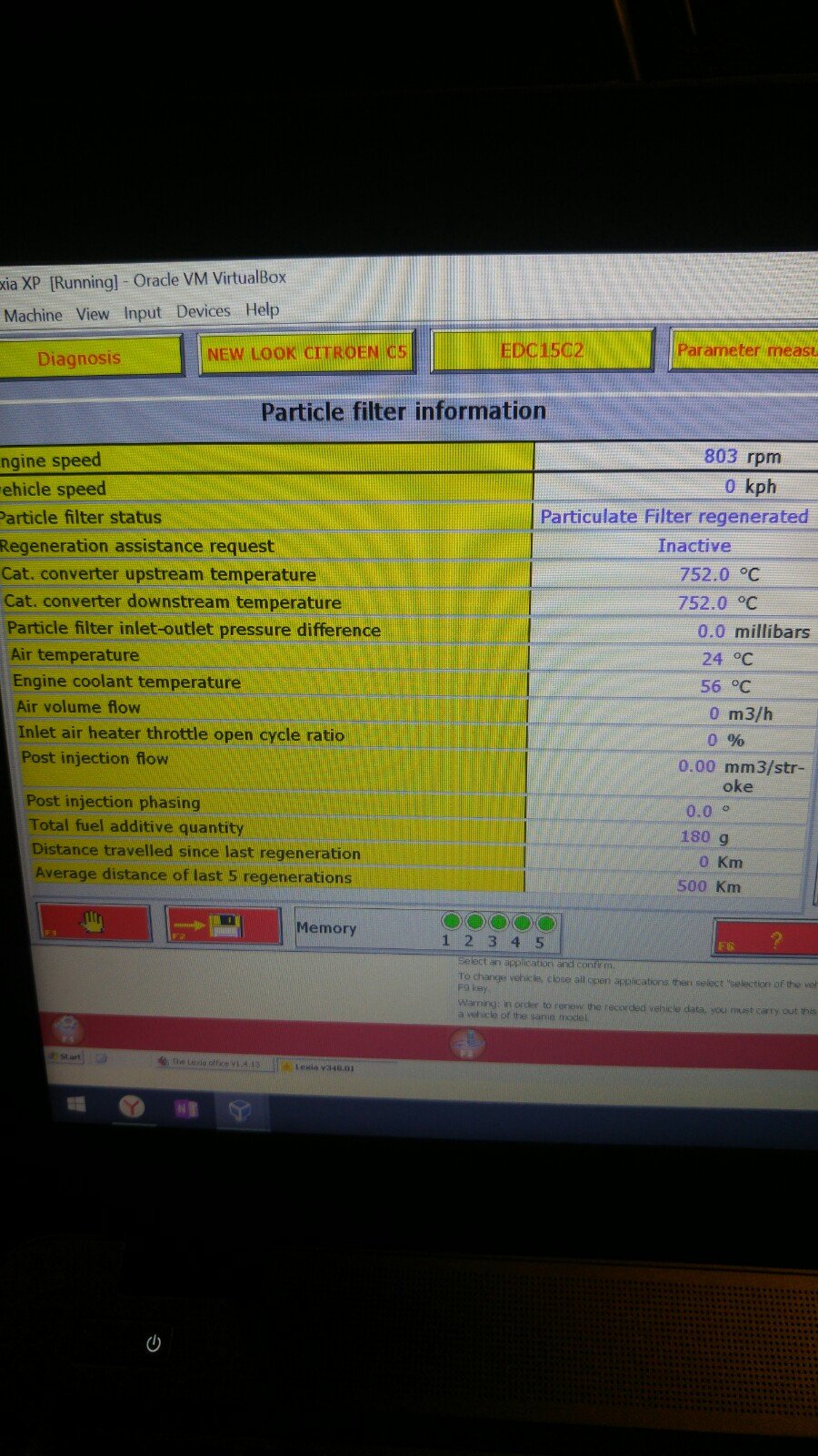

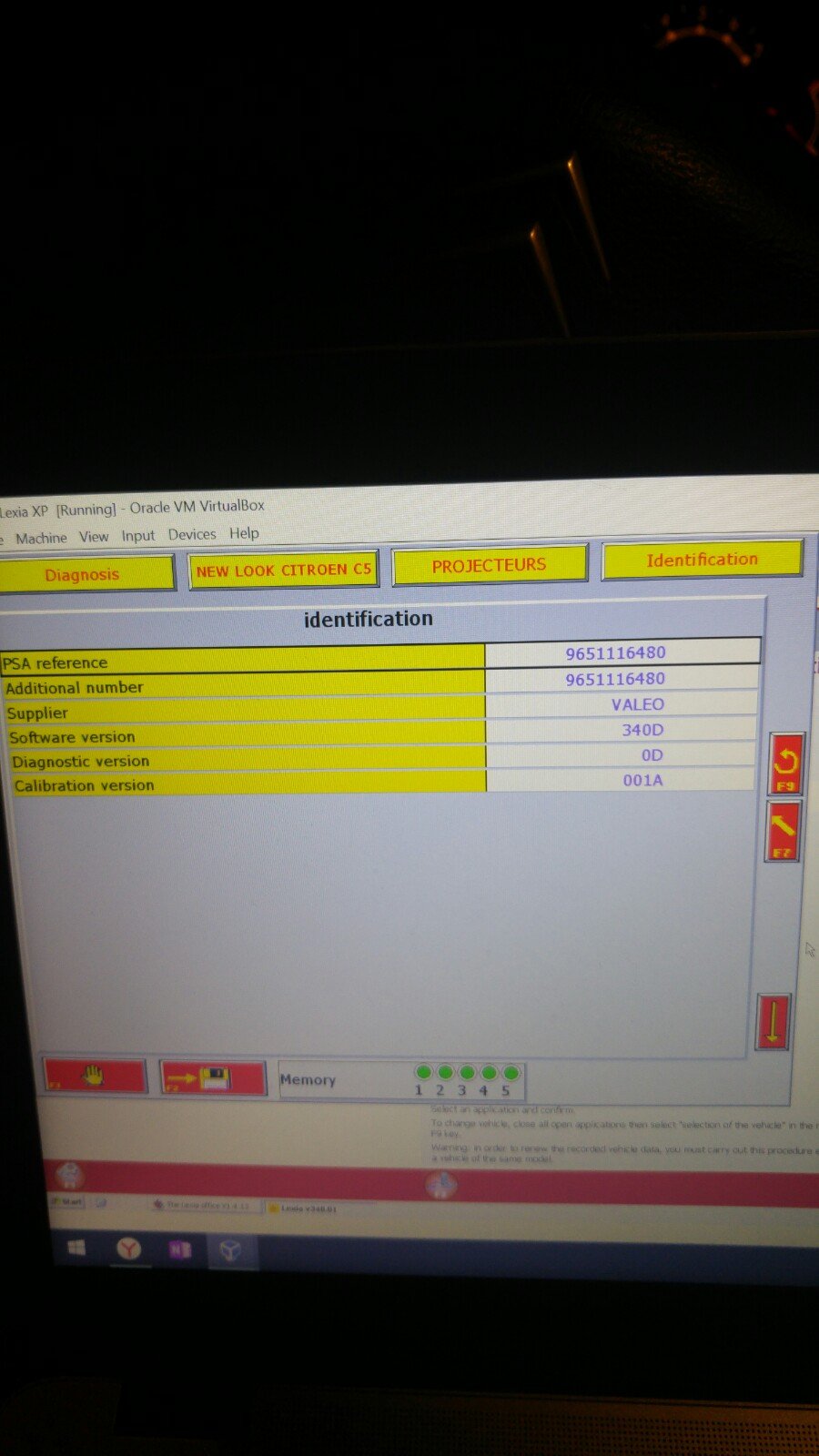

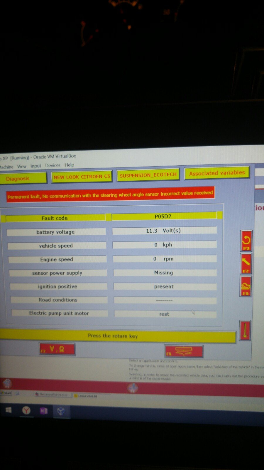

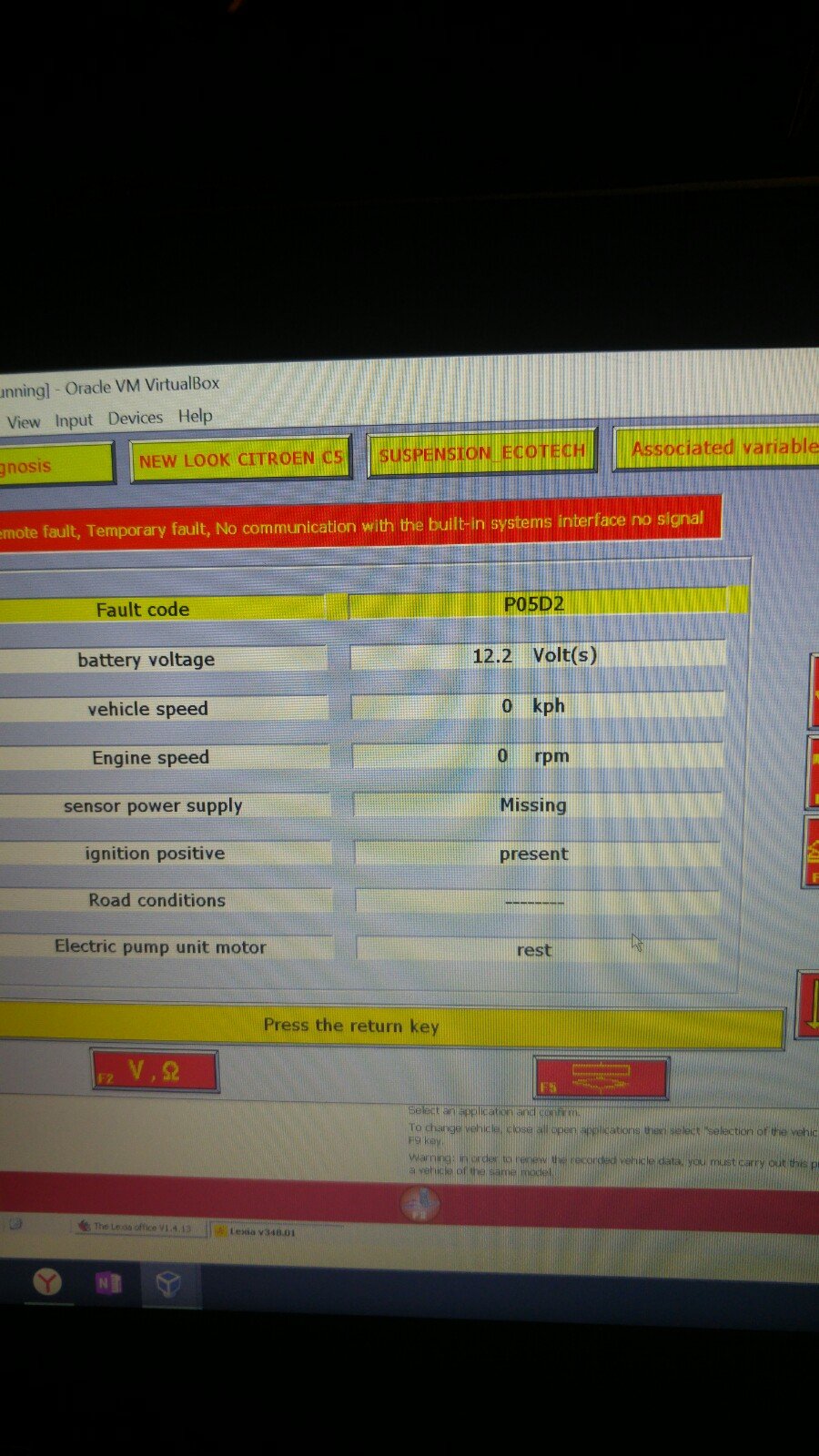

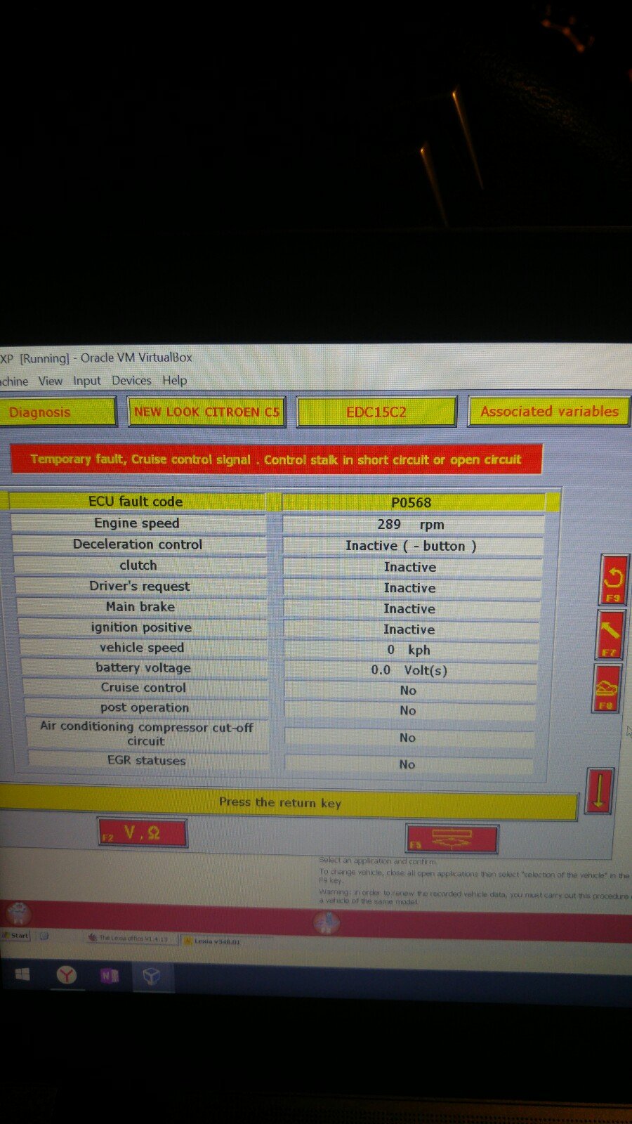

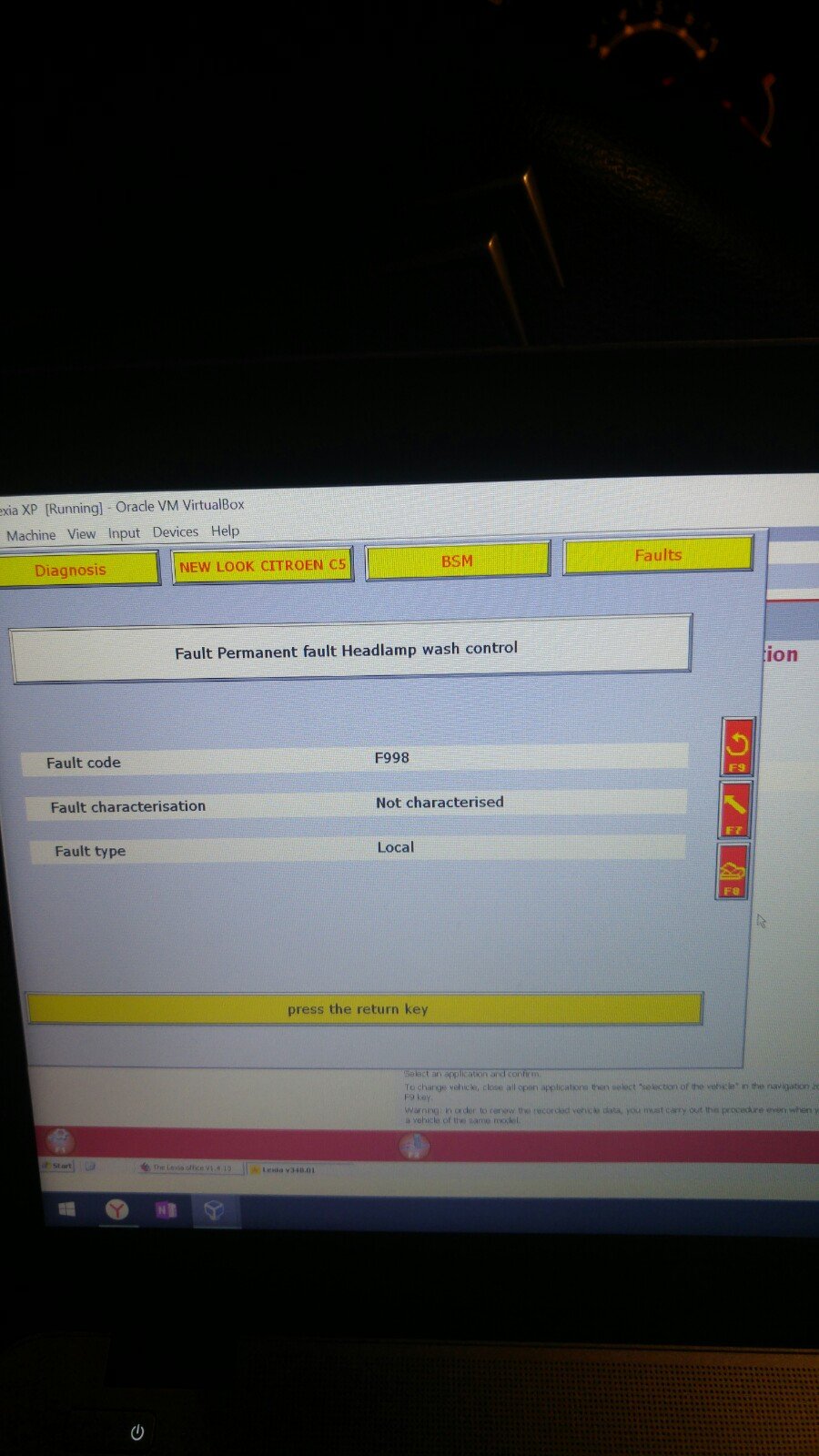

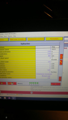

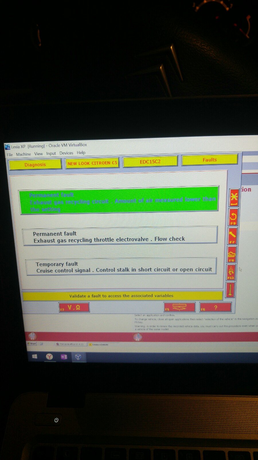

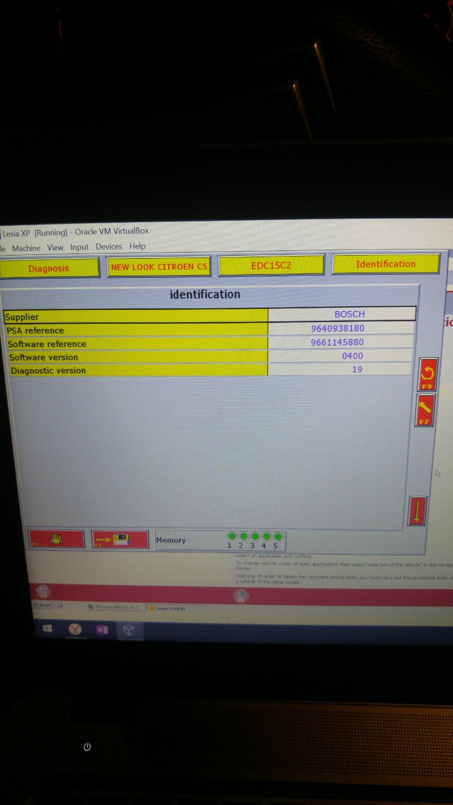

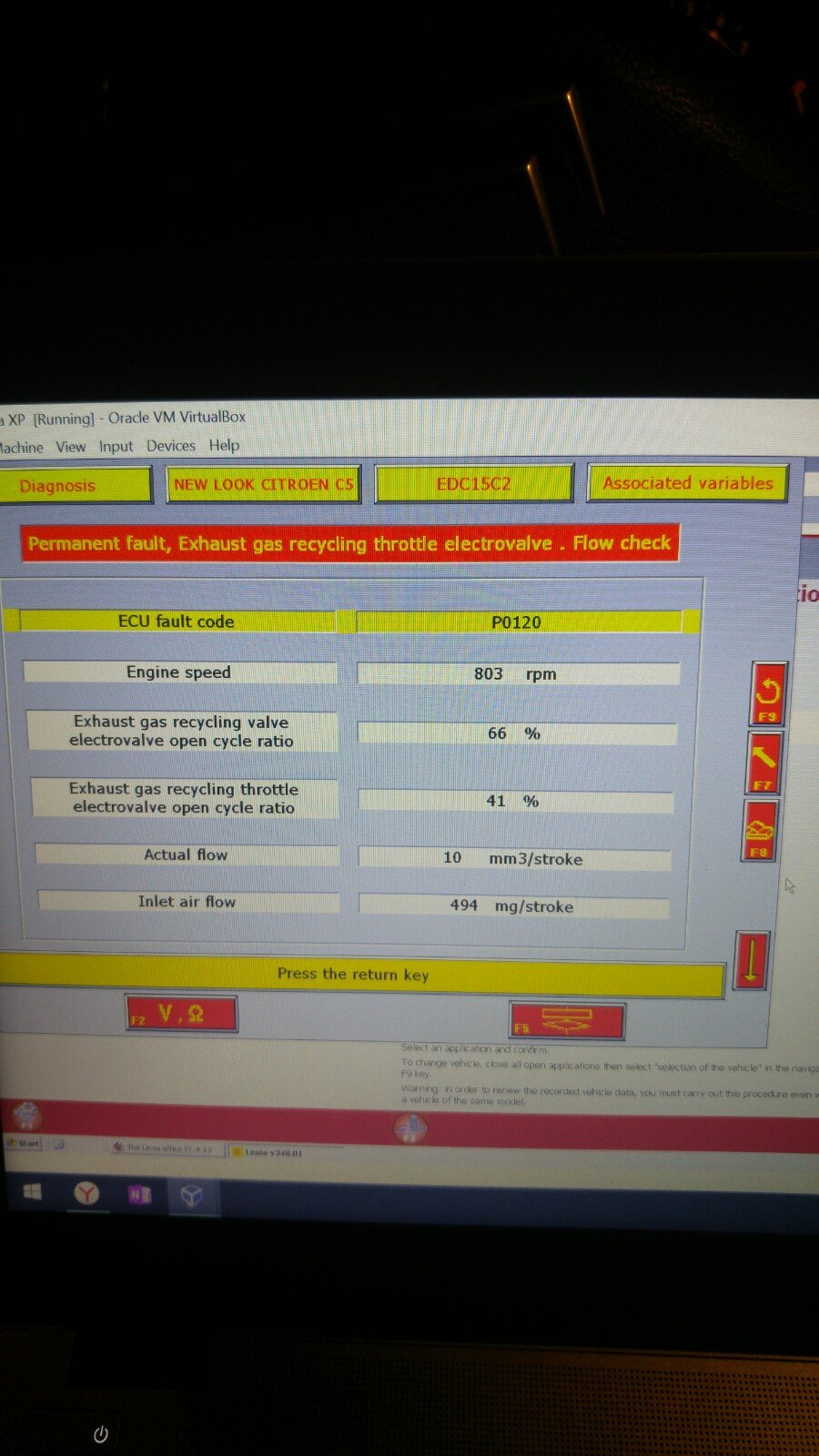

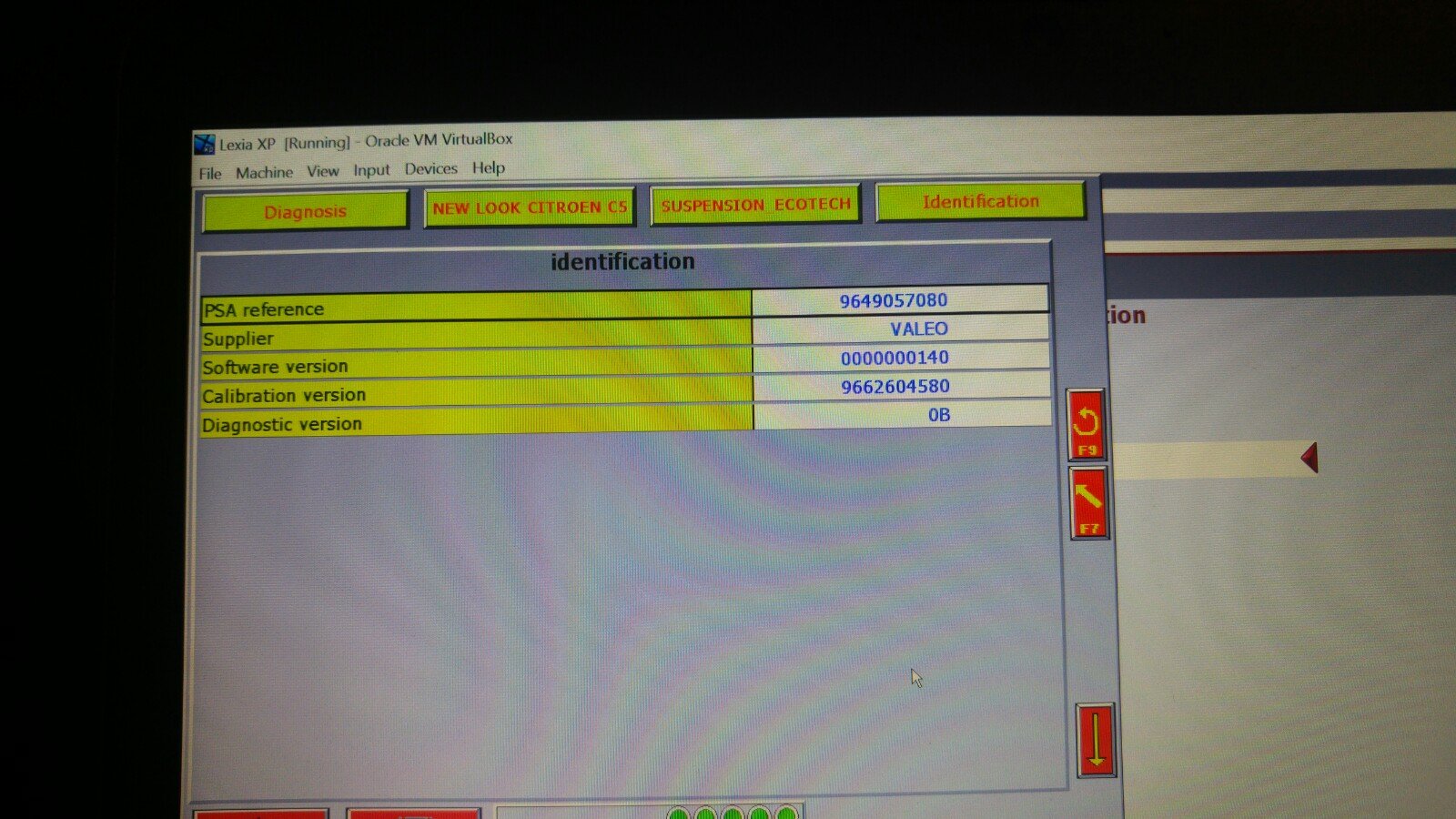

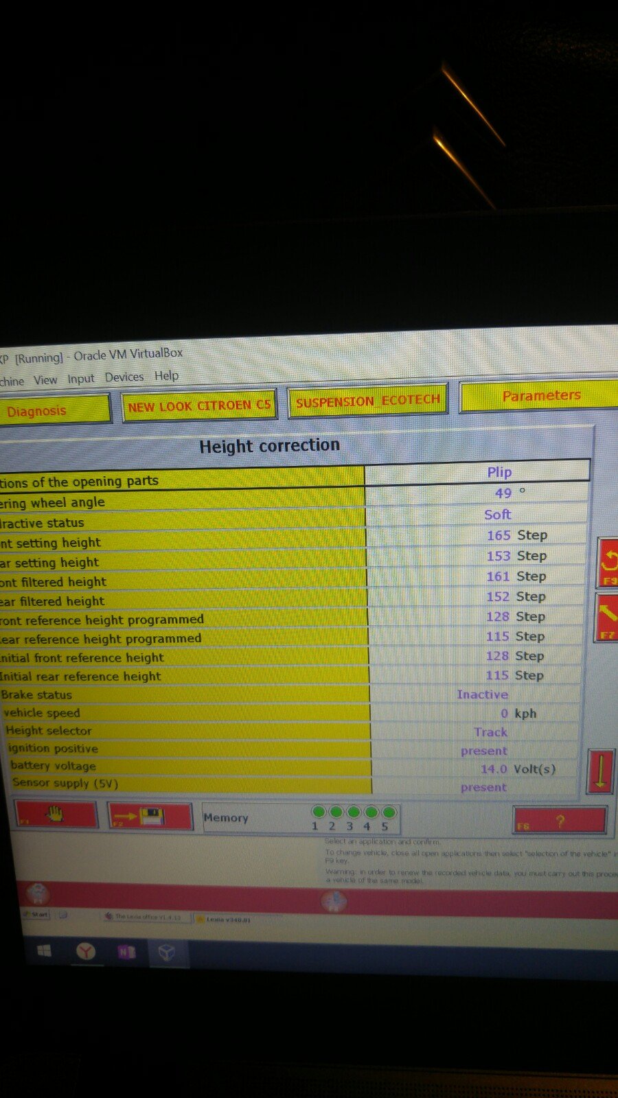

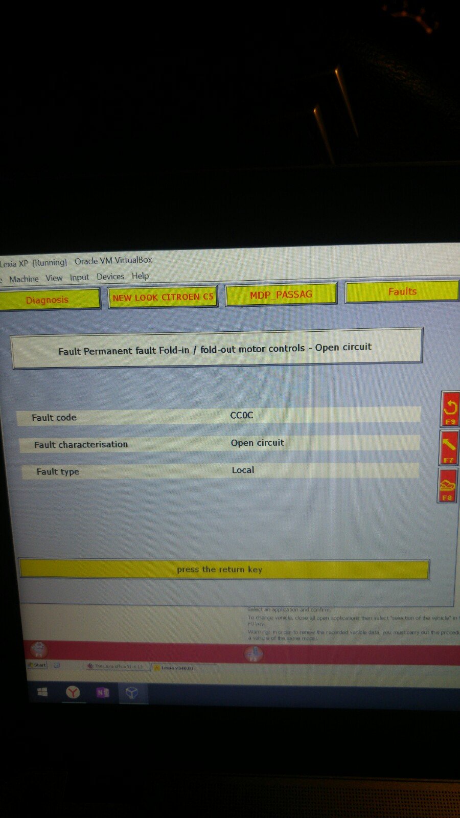

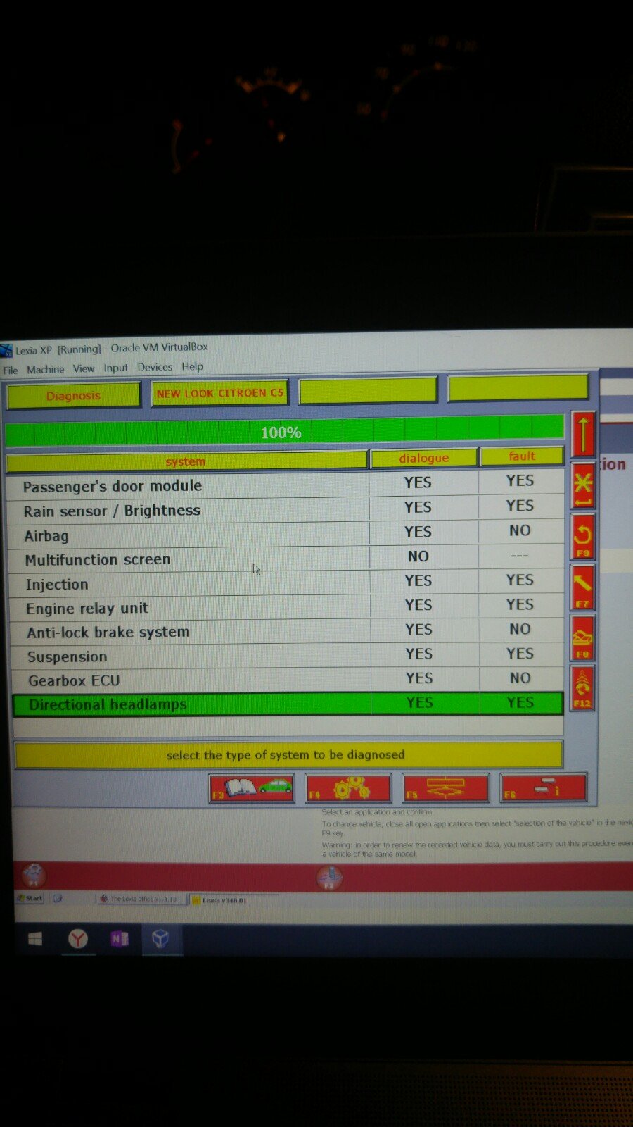

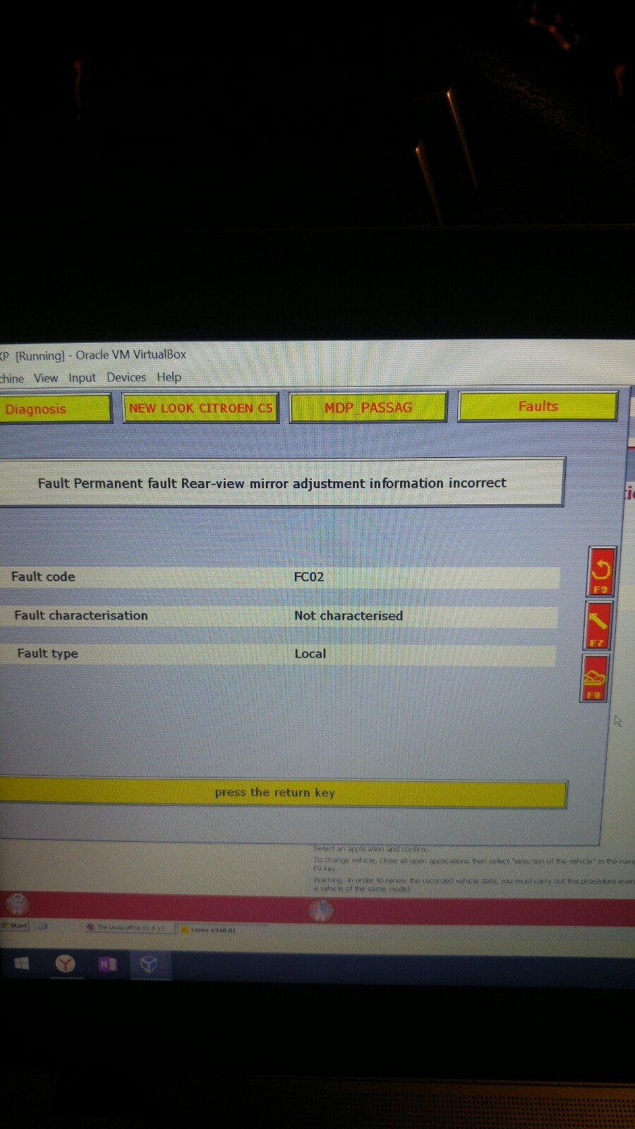

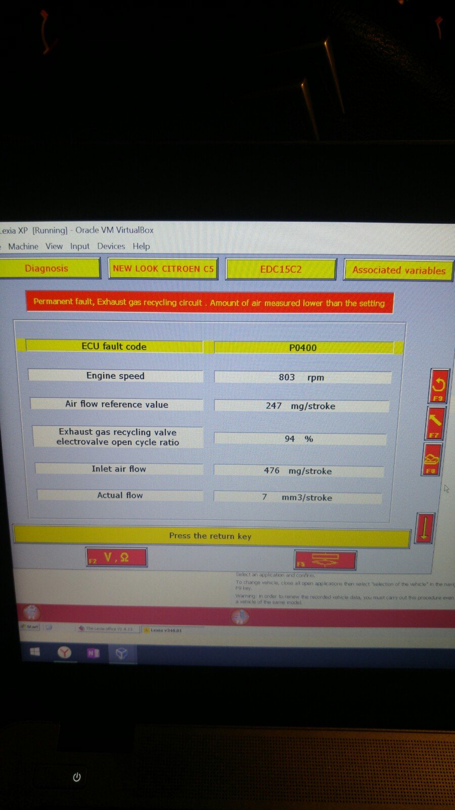

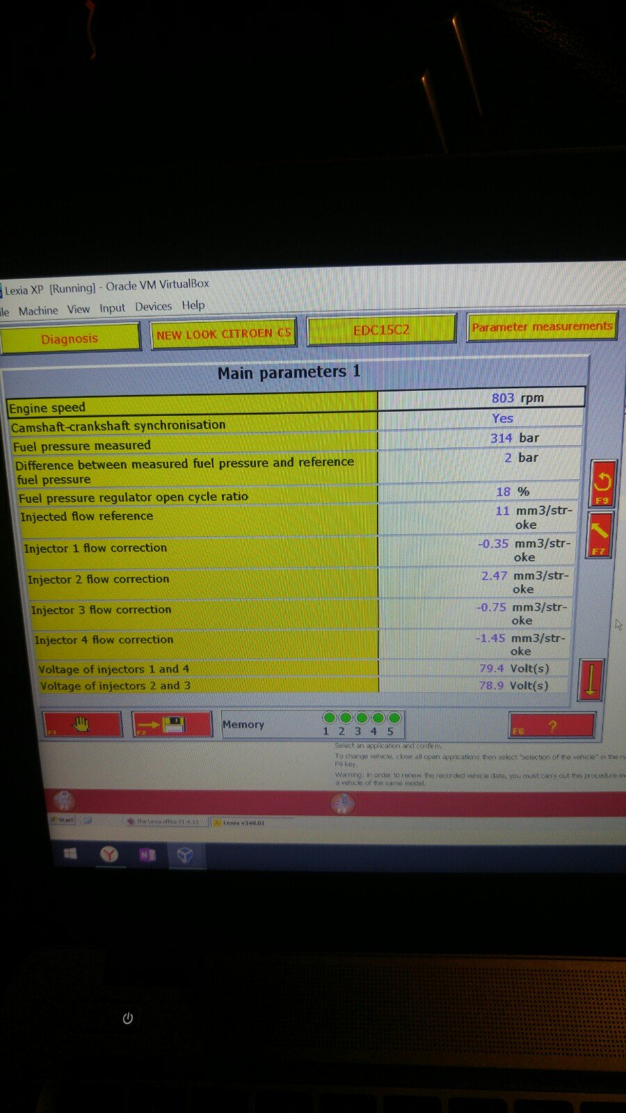

Hello guys,
sorry for the late reply but I could not find time to attach the car to the Lexia interface...
So here we go with all the errors I have (and there's quite a few unfortunately

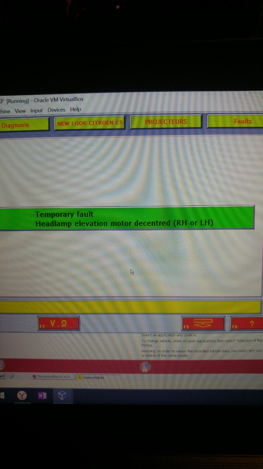

Directional headlights: :Headlight elevation motor decentered ... I did not have this error in the past when checking with the Lexia .. Suspension: BSM:
Ignition:
Other: I've tried making as much photos as possible without duplicating stuff...

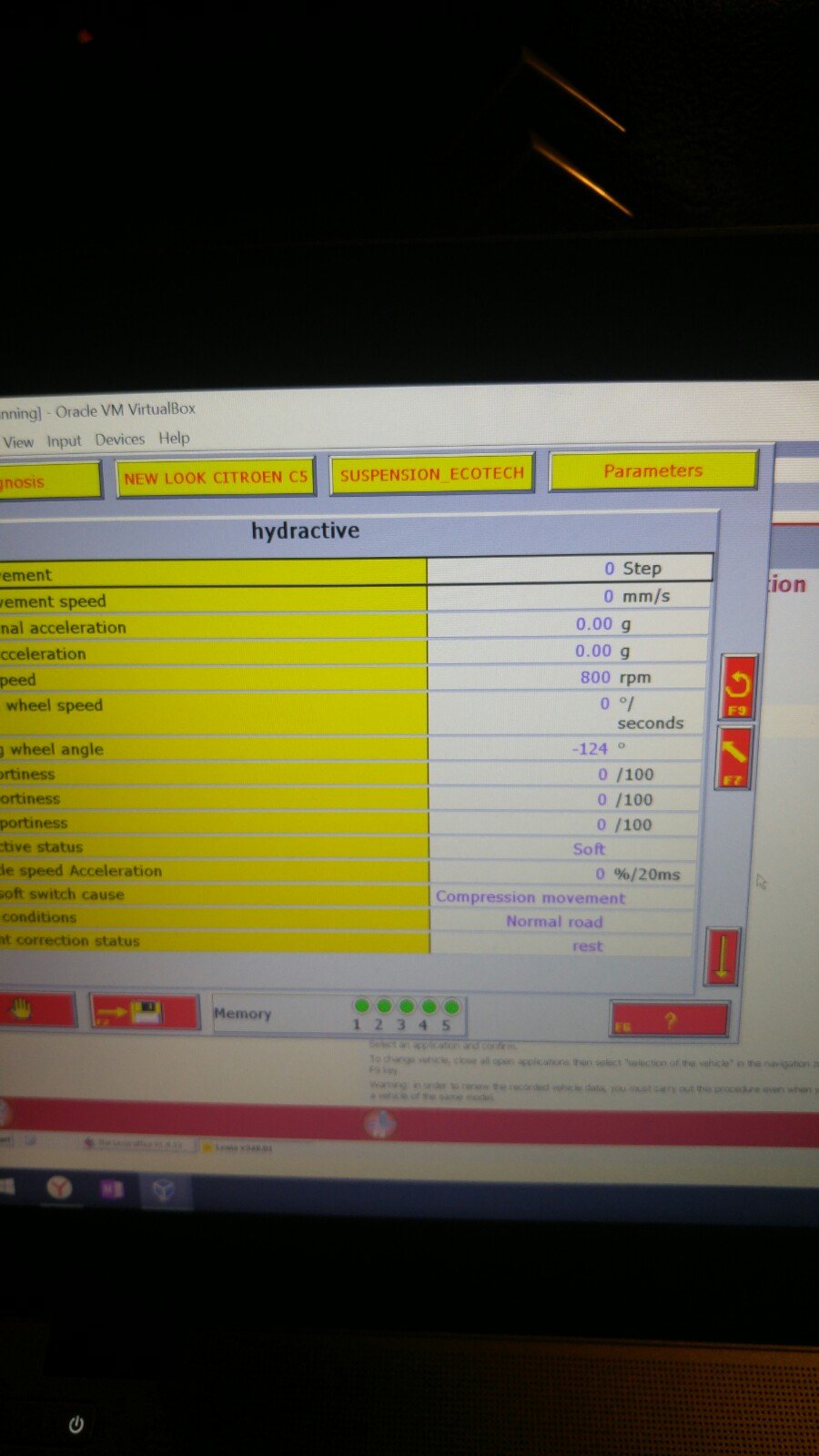

- I do not seem to have problems with the suspension. I have not yet check the ride height though.
- I did get the ESP/ABS error once in 6 months.
- I always get this error when I run the Lexia global report when it gets to the suspension part.
- I was not able to manually test the headlight movement via Lexia for some reason (Actuator test ...) The beams do move left/right with the stering wheel though (up until the error that is).
- It looks like there is a problem (judging by the errors above) with the wheel angle sensor - but when I test and move the steering wheel it does change values ...
Many thanks for the list and hope I get a resolution (maybe not only for the headlights)
Cheers and wishing you a great evening ahead,
V

So here are the errors and what I know about them :
1. Headlamp elevation motor decentered (RH/LH) - I assume that the problem might be here. I wasn't seeing this error before I believe. But it was present as well.

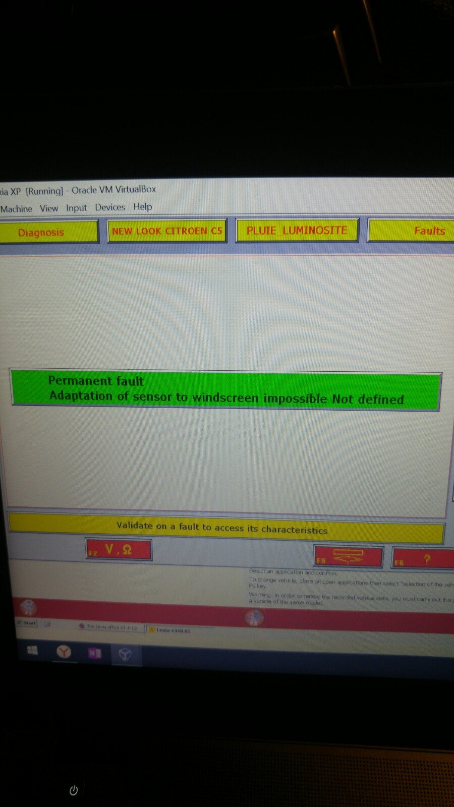

2. Adaptation of sensor to windscreen (aka Rain sensor) this is failing as the front windscreen was replaced before the car got imported from Germany and a chinese windscreen was placed instead of the original windscreen ... I will need to disable this in general from the Lexia if possible at some point as I won't replace the entire front screen just because of it...

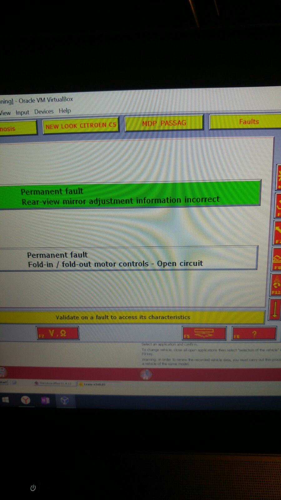

3. Fold-in Fold out motor controls - the left mirror folds - the right one does not. Manually also. I have purchased a working right mirror but have not had the time to fit just yet _ I am assuming this will fix it ..

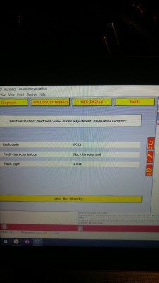

4. Rear-view mirror adjustment information incorrect - not sure what the problem might be - the rear-view mirror does dim when lights from behind are present although I do not use it really.

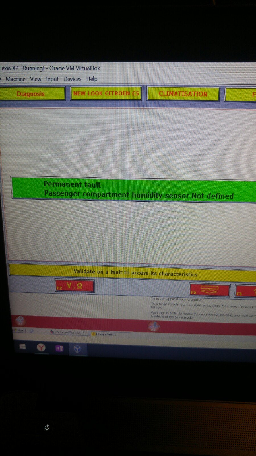

5. Passenger compartment humidity sensor - no idea what the problem might be - my climate control claps were replaced recently as I had hot air on the left and cold on the right -maybe something wasn't properly fitted after this intervention ...
6. No communication with Radio ECU - I do have a problem with the volume down button on the joystick - although I do not feel that this might be it ... all else works with regards to the radio ...

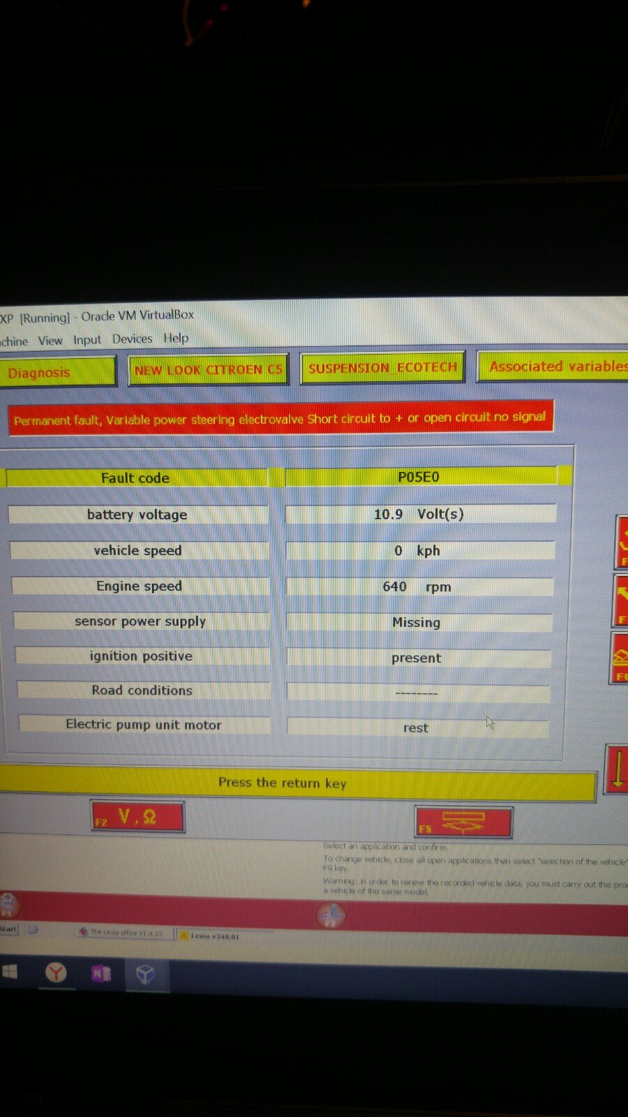

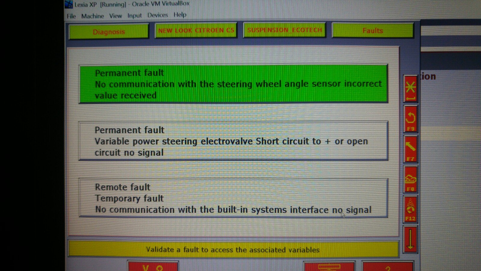

7. Variable power steering - I do not think that this car has it ... which might mean some setting was previously enabled and should not be ...
8. no communication with steering wheel angle sensor ( incorrect value received) - this could be the Com2000 failing (hope not as it costs 1/2 the car
9. No communication with the built-in systems interface no signal (temp fault) - no idea....

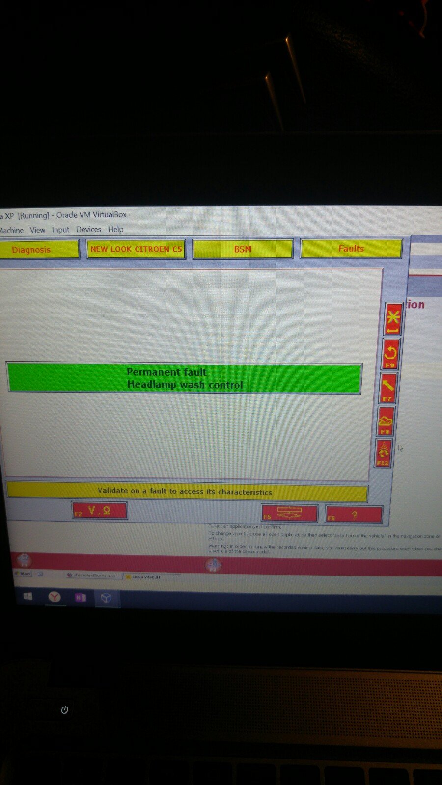

10. Headlamp wash control - afaik this has been disabled somewhere from the Lexia interface ... I would like to keep it as it is as it sort of fails often anyways ...

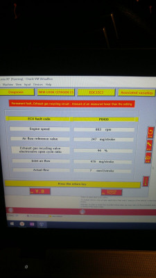

11. Exhaust gas recycling circuit - Amount of air measured lower than the setting - this could be the swirl valve - and there has been some manipulation done with it prior to me purchasing the car ... (the valve is fixed with barbed wire and does not function). Could be something else of course
12. Exhaust gas recycling throttle electrovalve - flow check. Could be the EGR - although it seems to work fine when I switch it manually (I hear some movement). Could be something else again ... I sometimes do get the Depollution system faulty error which I also clear using an ELM.

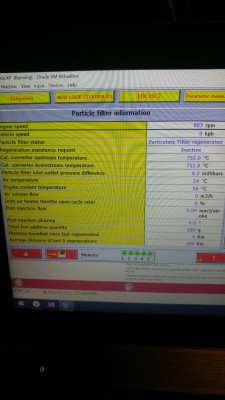

- I should note that the previous owner removed the catalyst and the FAP and I suspect that there might be some software intervention at play ...
13. Cruise control signal - control stalk in short circuit or open circuit. Cruise works perfectly fine.
Overall I do have quite a few issues. I have cleared the errors. Note that there could be errors because I was playing with the fuses a bit - since my rear wiper died on me and I did'n have another spare 15 fuse so had to temporarily swap an adjacent fuse to test ... this could have built a few of the errors above although some I have seen before this fuse game ... The motor of the rear died btw so searching for a working one as we speak.
How do I reset the BSI
I have tried resetting it holding the DARK button on the dash for a good amount of time. This fixed the no volume/up down from the dash radio button (it was stuck once and did not respond to anything pressed on the dash in terms of sounds/radio). Resetting it like this fixed it ...
** The battery is 2 months old so no issues here (100%).
But it appears that I have a french car with some wiring issues .... lucky me
Cheers,
V

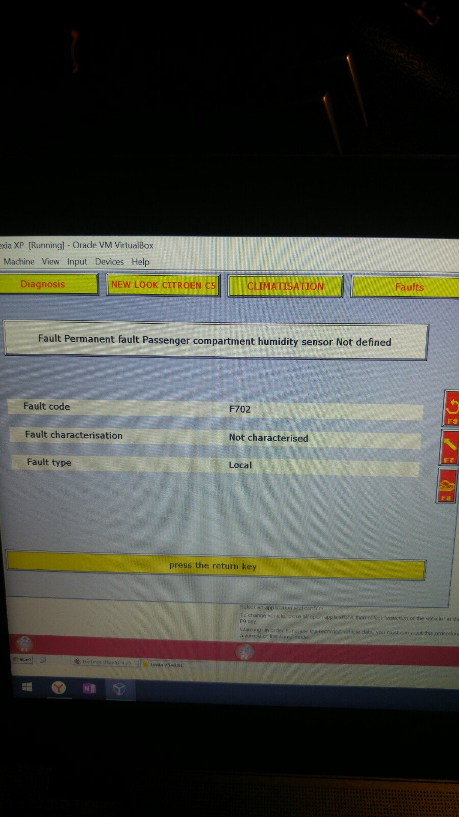

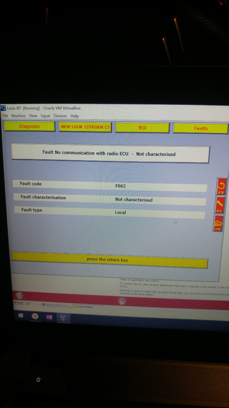

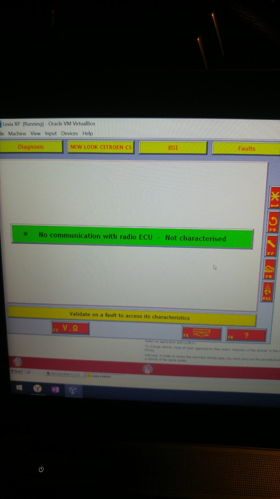

Re: Directional headlights fault C5
BSI reset/battery disconnection procedure here
Be very wary of pulling fuses while the system is powered up - most will be fine but others may not.
wbgenetic
- Posts: 30
- Joined: 03 Dec 2017, 07:57
I've only pulled the fuses out while the system was off - then started the ignition etc...
wurlycorner
- Posts: 2177
- Joined: 30 Oct 2012, 22:37
- x 271
So have we cleared up yet whether it is the self levelling aspect of the headlights that is faulty, or the directional movement?
Your comment;
Your comment;
(and the thread heading) suggest to me it is the directional movement that is faulty, not the levelling, however the "headlight elevation motor" fault, suggests self levelling would not be working?!The beams do move left/right with the stering wheel though (up until the error that is).
Iain
CX DTR T2 Safari (silver)
Iain
- Posts: 14318
- x 3298
If you don't mind my asking, how good is the battery? It is known that a failing battery can cause all sorts of gremlins in a C5.
wbgenetic
- Posts: 30
2 months old in perfect condition...
- x 6948
This won't be battery for sure - from the update the OP has given us - this seems likely to be the result of somebody being a bit creative with a Lexia.
At this point it is going to be hard to diagnose what is an actual fault, what is a communication error and what has been deliberately deactivated or activated.
As for the DPF / Catalyst being removed - I suspect that as Bulgaria is part of the European Union, that you may also find it illegal to use in public with these removed - so you may have to way up whether the car is worth getting back to legal road use....
So realistically speaking, I think you have a bit of a lemon. It would seem to be crippled basically. Forgetting the DPF / EGR issues for one minute as these could well be related to whatever damage has been done when the last owner removed the emissions devices - I would suggest if you are serious about keeping it, then you need to get the BSI properly configured first of all - with ALL the original settings correct as they relate to the equipment that was originally fitted to your car. Once you have that done, you can start troubleshooting what the actual 'real' faults are from the ones caused by misconfiguration of the BSI / intervention.As per the fault I mentioned - this can be the motors / communication on the network / height sensors / Steering Wheel Angle Sensor (seeing as you've now mentioned the Comms issue).1. Headlamp elevation motor decentered (RH/LH) - I assume that the problem might be here. I wasn't seeing this error before I believe. But it was present as well.
Windscreen - the light / rain sensor is a separate unit - so won't be the windscreen. But can be disabled - although I suspect as this is integral to the Comms unit and the BSI, you may still get errors in Lexia.2. Adaptation of sensor to windscreen (aka Rain sensor) this is failing as the front windscreen was replaced before the car got imported from Germany and a chinese windscreen was placed instead of the original windscreen ... I will need to disable this in general from the Lexia if possible at some point as I won't replace the entire front screen just because of it...Mirror controls - this will be related to the fault concerning the Driver's door module that controls these. There are a lot of different options for these mirrors, so get the right one - however with the fault still present in the module - with everything else it is hard to say whether this has been misconfigured.3. Fold-in Fold out motor controls - the left mirror folds - the right one does not. Manually also. I have purchased a working right mirror but have not had the time to fit just yet _ I am assuming this will fix it ..Again this may be related to misconfiguration of the BSI or communication on the network4. Rear-view mirror adjustment information incorrect - not sure what the problem might be - the rear-view mirror does dim when lights from behind are present although I do not use it really.These rarely go - it is usually the air mixing flaps (which you say have been done) , the air heating resistance or the blower motor sensors - so cannot say if this is an actual fault or associated with some of these other errors.5. Passenger compartment humidity sensor - no idea what the problem might be - my climate control claps were replaced recently as I had hot air on the left and cold on the right -maybe something wasn't properly fitted after this intervention ...The Radio ECU - has this been configured correctly or not? - if settings have been changed in the BSI and EITHER the wrong head unit has been selected OR the wrong options have been set for the system, this can cause all sorts of problems. - there are options that are controlled by some Head Units like the RT3/4, which should not be enabled for other head units - dong so will cause major problems with the CAN network - such as rear view mirror indexing, auto lights, climate control, directional headlights etc., etc., conversely if the RT3/4 Navidrive options have incorrectly been set for an RD2/3/4 unit then the same will casue problems.6. No communication with Radio ECU - I do have a problem with the volume down button on the joystick - although I do not feel that this might be it ... all else works with regards to the radio ...The power steering is different depending on engine and trim level - some are 'Variable' and others are 'Unvariable' According to your VIN you have 'Unvariable' so it is just assisted..7. Variable power steering - I do not think that this car has it ... which might mean some setting was previously enabled and should not be ...I suspect either this needs to be calibrated - or it is symptomatic with the comms network as this will have a direct effect on your ABS / ESP system - as in you won't have any of these functions operating until this error is corrected. Again - note the input from this system to the suspension ECU, the Healight ECU, the ESP / ASR / ABS ECU and the BSI as already mentioned.8. no communication with steering wheel angle sensor ( incorrect value received) - this could be the Com2000 failing (hope not as it costs 1/2 the car)
Well the BSI is the main computer which controls the other ECUs and enables / disables just about every function on the car. The BSI configuration parameters are what you are changing when enabling / disabling / configuring options with Lexia - some items refer directly to the specific ECU concerned and others are done within the BSI itself. But the BSI has control of most of the car systems - and is critical to the operation of the vehicle.9. No communication with the built-in systems interface no signal (temp fault) - no idea....
Misconfiguration can leave the car inoperable.This would be essential for your MOT in the UK - as you have directional headlamps (currently working or not) and where this system is fitted it is required to be working and operational to pass, but I note you are in Bulgaria - so not sure what your laws are....10. Headlamp wash control - afaik this has been disabled somewhere from the Lexia interface ... I would like to keep it as it is as it sort of fails often anyways ...I would say that these are probably the least of your problems - and can be addressed once you get to the route of the causes for everything else.11. Exhaust gas recycling circuit - Amount of air measured lower than the setting - this could be the swirl valve - and there has been some manipulation done with it prior to me purchasing the car ... (the valve is fixed with barbed wire and does not function). Could be something else of course![]()
12. Exhaust gas recycling throttle electrovalve - flow check. Could be the EGR - although it seems to work fine when I switch it manually (I hear some movement). Could be something else again ... I sometimes do get the Depollution system faulty error which I also clear using an ELM.Just seeing this little nugget dropped in at the bottom has really done it. As you probably know, that is illegal in the UK (not sure about Bulgaria - but you would need to check your insurance is not void) for a car used on public roads, so if this has been done - the perpetrator has either had a software map applied or completely crippled the BSI to try and hide the fact.- I should note that the previous owner removed the catalyst and the FAP and I suspect that there might be some software intervention at play ...Probably symptomatic of the ESP / ABS communication / fault - which will normally disable the system if there is an error - so again this leads me to suspect someone has bu**ered up the BSI configuration13. Cruise control signal - control stalk in short circuit or open circuit. Cruise works perfectly fine.

A reset to factory conditions and then a software mod to remove the DPF, should get it sorted?
(Not recommending / sanctioning DPF removal btw, just reflecting reality on the car and that replacing the DPF now is likely to be a bigger PITA/cost)
