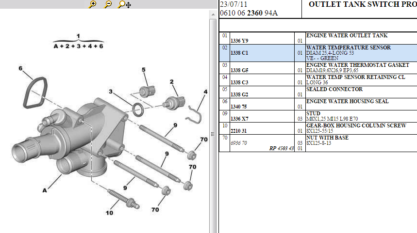

Part 1336 Y9 is actually the complete assembly Pete - (Engine Water Outlet Tank).
Part 1338 C1 that i mentioned in my previous post is the actual temperature sensor:
Click Picture to Zoom So if it is the complete housing you need - I would try and get the correct one 1338 C1 - as these 'equivalent' generic ones can fit many vehicles.

As per my other 'stat thread re the car taking a while to get warm/not getting as hot as it used to, I've bought £50-worth of 1336Y9, thinking that was the only way of getting a new thermostat. Am I right in thinking I could have just bought less than £10-worth of 1338C1, and that would sort out my problem?! Or do I actually need the complete housing as the thermostat is buried inside it?
The complete unit is returnable though, so all is not lost if I don't need it.....

Yep, the water sensor is available as a separate part and about £5 ish Pete, as you can see on the diagram.
That’s what was confusing me as to why you would want the whole thing

The sensor, which is clipped in just sends a temperature signal to the ECU. The thermostat which controls the water temperature is moulded into the housing.

That makes more sense.
