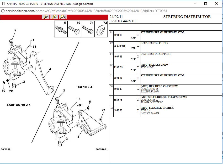

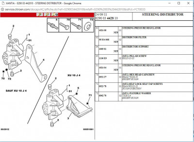

Thanks for the reply V6. We did check the bearings out and they seemed to be absolutely fine. We're wondering whether there is an issue with the pressure regulator for the steering, it's as though it's receiving full pump pressure with no escape when the steering hits full lock. I've had a look on servicebox and found this device (see attachment).
With a quick googling of the part number, it comes up with this page, which mentions it being for a Xantia, however it is right by the starter motor, ie where the pressure regulator is on the XUD and XU10 engine. Does anyone recognise this engine and know what it is? And why the regulator isn't where it should be?
https://bartebben.com/parts/citroen/xan ... ierop.html
Any thoughts chaps? Thanks

On all Xantias with 6+2 pumps (except the V6), the steering pressure regulator is built into the pump.

That looks like the FDV fitted only to the very early 'Sinker' Xantias to me Dom...
