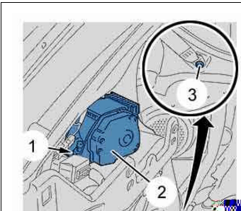

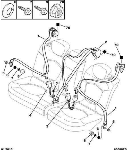

Does this help? Click to zoom the pictures.
The refitting just says remove the bolt (3) and the nut (1)!

That does, thanks very much - looks like bolt head - stalk - belt - car. Ah, interesting, the stalks come out of the front too - I guessed the wrong way round.

Though that picture of the middle belt looks wrong - there's an extra belt drawn which shouldn't be there surely? Belt goes from the bottom, through clip, to reel at top, nothing more. Rather than bottom, to reel, then a second belt from the reel to the clip at the end,
