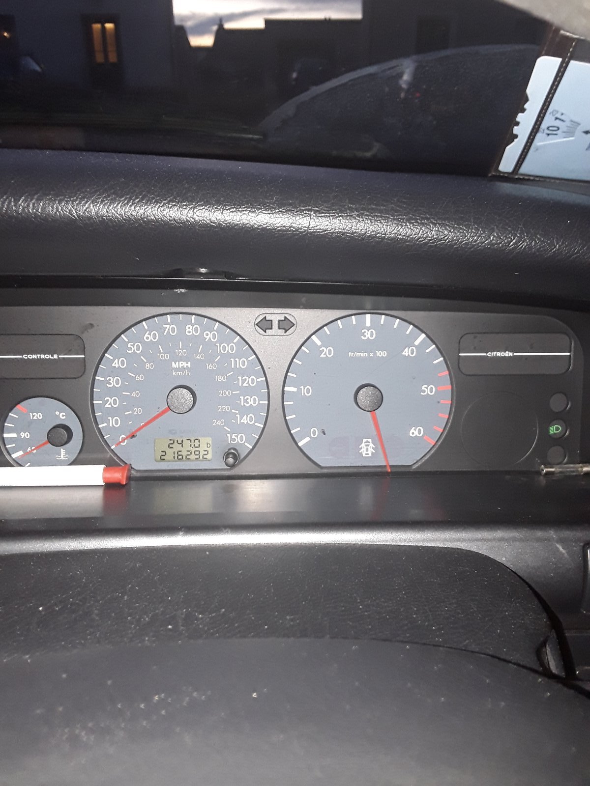

She's definitely an S2. This is where the rev counter is stuck
Those previous threads say pull the needle towards the rest position. Surely it needs pushed so it gouge all the way anti clockwise round to the stop at zero? I haven't found a thin enough piece of wire to get in yet, and the trip reset button is not pulling out as someone said.
