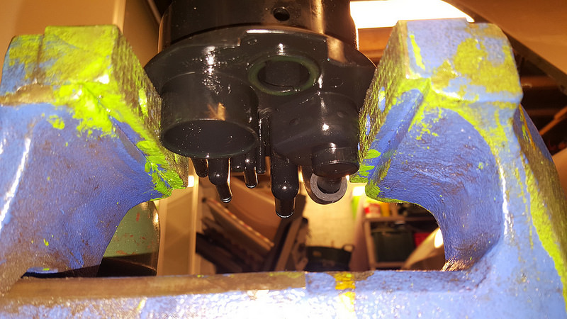

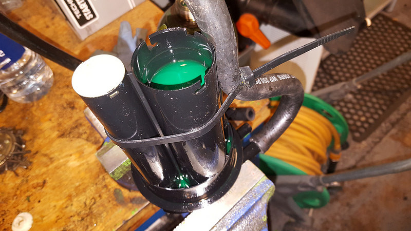

Hi Simon, no the seal you mention was in place and while the triangle flange is off it appeared to still stand proud of the surface so should make a good seal. It might be that the use of sealant did cause the air leak the first time although I did use marginal amount of sealant the second time that seems to be working well. I did attempt to replace the O ring with one from my collection of metric O rings but there wasn't any one that fitted.
I tested the LHM tank filter block here to see if there was any leak at the plastic plug (bottom, right here) that is in the moulding. The vise isn't clamping the plastic btw.
Image20180120_171959 by Graeme McNulty, on Flickr
From the top, filled the suction part with LHM to see if it leaked out from the plug over several hours, or indeed if it leaked out anywhere.
Image20180120_171951 by Graeme McNulty, on Flickr
It was completely fine.

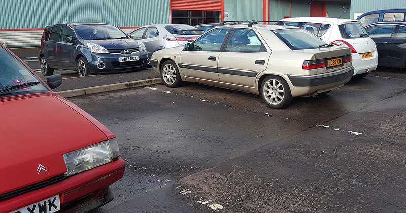

Anyway, it's still all very good - no bubbles at all after another day. I took Auld Katy to work today (usually cycle) 5.5 miles there and all good. The steering is actually nice and light and smooth.
All new LHM flushed through as well and the sinker is not currently sinking!
After several hours:
Ignore my colleague's BX, Auld Katy is still unsunk
Image20180124_101818 by Graeme McNulty, on Flickr

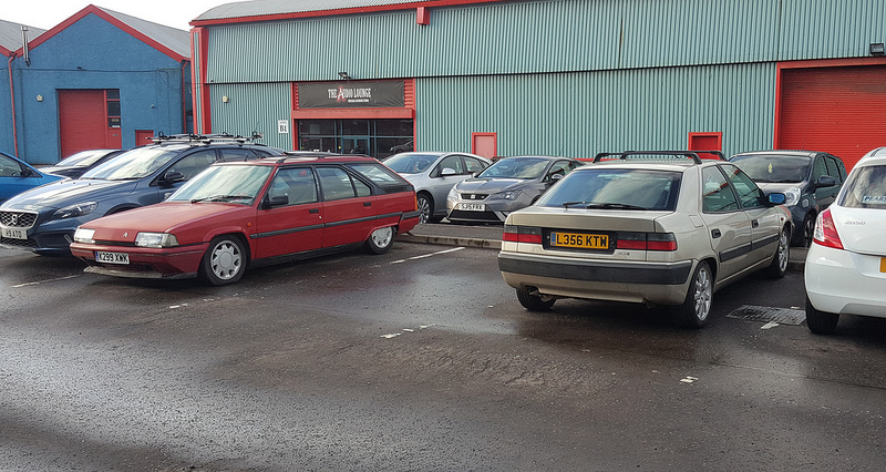

This was after 5hours, usually the front is on the stops after 1hour and the rear not long after!
Image20180124_101831 by Graeme McNulty, on Flickr
By the end of the day the front had sunk a bit but it is still impressive for a 25 year old system!
