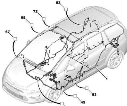

The BSIs are usually contained in the passenger glovebox area so well above water. However, if these are anything like the other models, there will be wiring under the passenger side floor carpet as a result of the left - right hand drive conversion process, so if there is wiring that is damp or 'floating' it won't be very happy.

^^ Did you investigate / dry out the water from under the carpet yet as I mentioned? If these are soaking where there are any joins, you'll likely have problems...
They'll need drying out and probably some electrical contact spray - but always disconnect the battery negative before you investigate / cleanup as you won't want to cause a short or worse activate an airbag.
Here's the Intermediate harness - so you can see the location:
