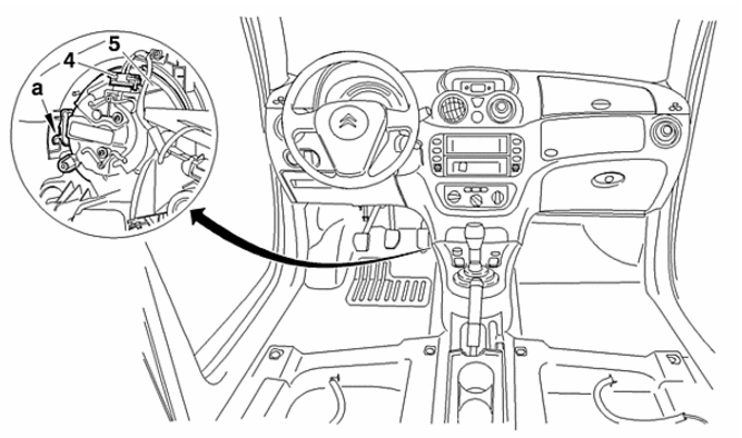

The diagrams should help below. However the second one is for a left hand drive, so you'll need to access it from the passenger side. Click to zoom these up.
Disconnect the connector ( 4) of the blower (5).
Press the tab on the blower (at "a").
Turn the fan ( 5) clockwise to disengage it from its retaining lugs.
Remove the fan ( 5) by separating the intermediate shaft.
