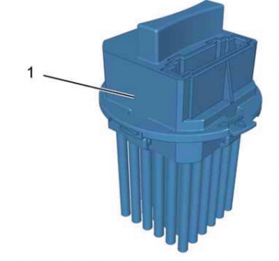

As for the heater issue, it sounds like the Air Blower Control Module as it is the fan that is not working as opposed to no heat. Check Fuse number 11 in the passenger glovebox fuse box first. Another possibility is the A/C Electronic Control panel on the dash - but again a diagnostic is essential to pin it down
This is the digital Air Blower Control Module
Again if you are going in for EPB check - they will be able to diagnose this at the same time (as part of the same fee) so makes sense to get it done in one go.
