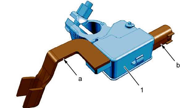

Check the battery first (charge it on the car if possible) - connect the battery charger positive to car positive first, then charger negative to battery negative (but if your battery has a battery charge status unit as shown below which is connected to the battery negative, connect the charger negative to the flat blade of the unit ('a' in the diagram) and not the negative post of the battery), then finally connect the mains of the charger.
