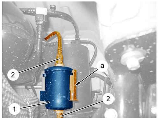

Re: Does it or does it not ------------
Another reason why I wanted to have a check. It should be under the rear RH wheel arch as you say:
You detach it from the clip at (a), then there are 2 click-fit unions at (2).
I'll give it another check, that's what I found as well Marc. The above diagram!!!!!!!!!!!!!!!!!
Well had a chance to check the C3 and I found a black plastic container/cartridge which has two plastic pipes running to its base. Its located on r/o/s.
I believe they are the supply pipes from fuel tank to filter and exit to injectors at front of car.
Black pipe with connector runs from tank to 'filter' and blue pipe moulded to outlet running to injectors.
Does anyone have the same type of filter and how do you change it ?
I think I've what this is 'CANISTER DEPOLLUTION ABSORBER' has this replaced the fuel filters on these cars.
Kenny
Kenny
Further to the above it would appear this C3 does not have an external fuel filter but this is within the tank itself .
