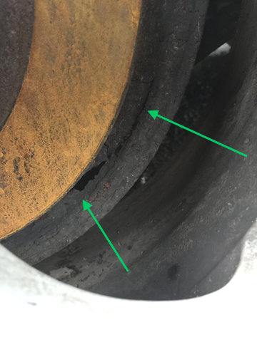

So had a bit of a shock getting out of the other car yesterday, when I noticed something not quite right near the C5s rear discs. Got out and gave it a good poke - then shot off to check what is was - turned out to be the 'Brake Disc Protector' had rotten through in places, leaving an odd shape - which is what initially concerned me:
Oh, ignore the surface rust on the discs - they are newish, but the car doesn't get used for days on end!

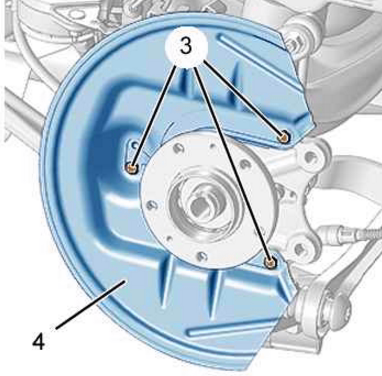

I checked the part (4209 A8) £37.06 Each! - A lot for a piece of cheap tin by the looks of it.
So looking at it, the pads, calliper and disc has to come off to get to the bolts that hold it on - but thankfully not the hub as some would seem to be fixed to.

As said it would only fail if its insecure,leave it alone. If you attempt to replace it expect one or more of the bolts ( 3 ) to snap off causing more grief.

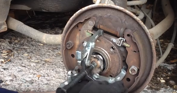

Looking at the Brake Plate for a 406 with Drum brakes - this would seem to be the part referred to in the MOT as it has a lot more gubbins on:
I don't like the look of the offside one, as that has the flaky part left after some has broken away. As you say Jim, I think it better to replace as they would seem to keep a load of crap away from the other components, plus I wouldn't want any more bits breaking up and getting into places that could cause more damage.

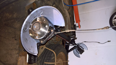

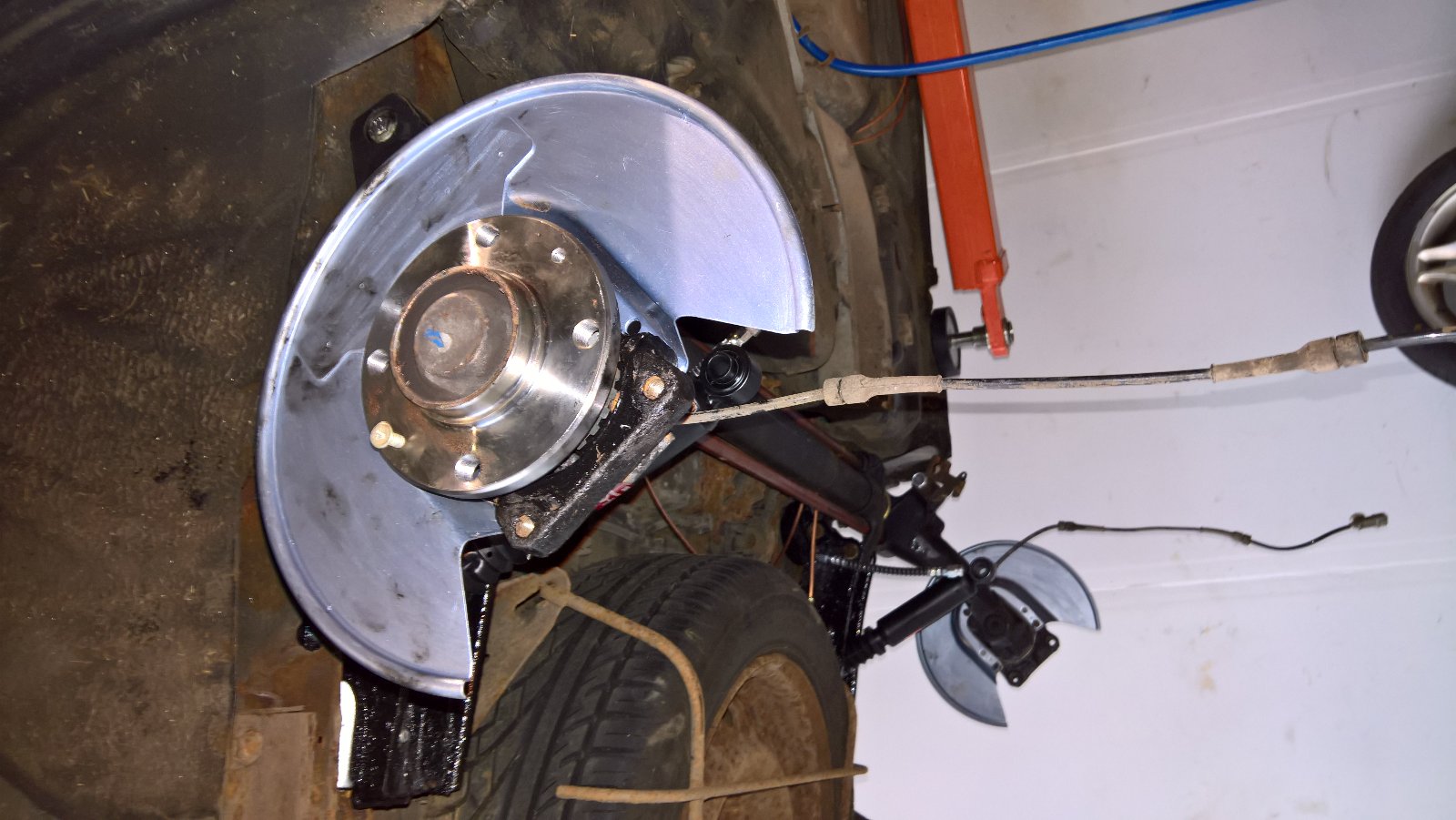

2nd agreement sort of. Changed mine, but with the axle in bits off the car. cleaned up all around all the bolt heads to get a good 6 point 10mm socket on. was advised to use impact wrench to 'shock it'. First side 2 out of 3 sheared. Other side, first one sheared so switched to manual 1/2" wrench and gentle increasing pressure and it came out fine (As in, i'm a weakling and was shocked how easy). Same too with the last one. A C5 is possibly similar to my 2003 Xsara and I've never attempted changing one on a Xantia but all I can advise is don't use brute force.
The grief with the ones that sheared was fixed by tacking them on with a little bit of weld through the open holes. Also, the new plates look like uncoated mild steel so give them a lick of paint first.
I gave mine 2 brushed on coats of what I think was silver body shop spray paint, then got loads of black hammerite on it off my gloves as I was painting other parts at the same time.

Indeed. The 406 one would best be described as a drum brake back plate, whereas yours would be best described as a disc brake dust shield/plate.
Drum brake back plates really do need to be sound as they have quite a few forces put through them as most of the braking components (excluding the drum itself !!!) are mounted to them !
The MOT confusion seems to come about as 'brake back plate' can be interpreted as covering both disc and drum plates, whereas I'd assume it's meant to be directed at drum brakes or brakes that have braking components directly mouted to the plates - and NOT disc brake dust shields.
