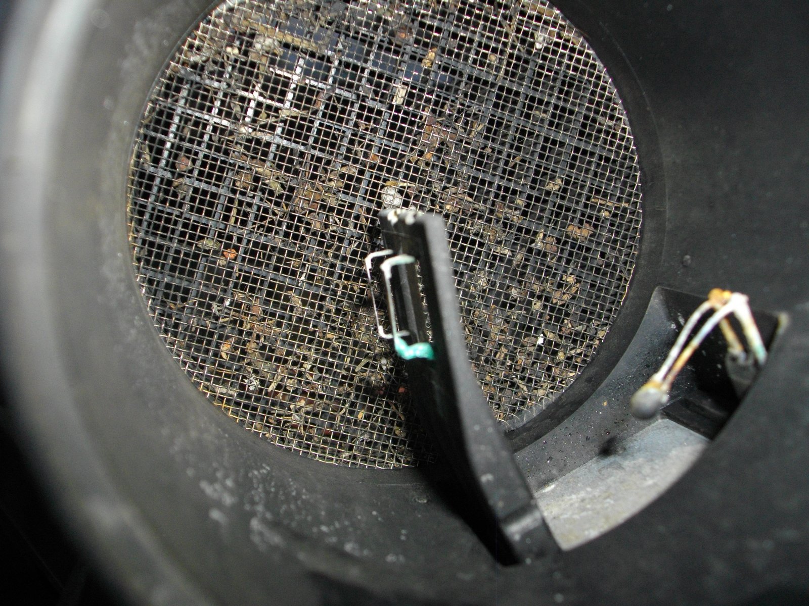

Re: Citroen C5 2.2L shudders on acceleration and under load
If the air filter is wet then the MAF may well be contaminated - happened to me a while back when my wheel arch liner disintegrated and the 'snorkel' thingy sucked up a load of spray and roadside crap.
You may be able to resuscitate it with carb cleaner - this has worked for me but the one above was way past that.
Will take a look.
The gauze looked clean from the side I was spraying egr cleaner into (even before I started) but will have a look the other side now, just in case.
Thanks
