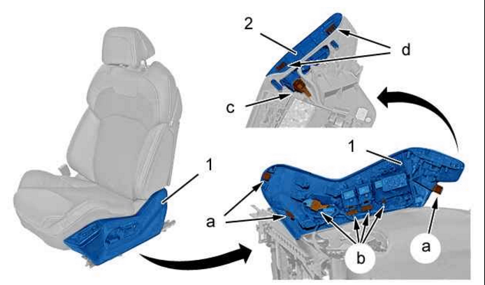

Assuming you have the full leather option, the X7 has 3 parts to the heated seats:
  • A heated Pad in the Seat Cushion
  • A heated Pad in the Seat Back
  • A Heated Pad Regulation Unit
There is a temperature sensor incorporated into the seat Cushion. The Heated Pad Regulation Unit controls the heat based on info from the heat sensor and from the rheostat thumb wheel switch selected by the driver / passenger.
As the heat is obviously working, the most likely culprit is the rheostat thumb wheel switch - and is the most common failure in other cars too. You can test this by swapping the passenger switch over. If this switches the heat off on '0' then you know it is the switch. The Citroen part number is 8906 HR and in the UK is £38.15 inc. 20% VAT.
The seat side trim panel can be removed carefully, by using a trim tool. It is held in place by small plastic clips (a). Be careful of the connectors at (b) and (c)
