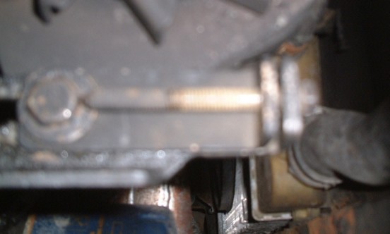

hello!
"SKREEEEECCCCCCHHHHH"..
Thats the noise thats eminating from around my fanbelt area.. my first thoguht was the cahnge the belt... did that... & now it goes screech more!!
What does the alternator sound like when its dying??
<font color="red"><font size="3"><u><b><center>**UPDATE**</center></b></u></font id="size3"></font id="red">
<center>OK, so its a engine-crank pulley to alternator-pulley belt *not fan belt as i might have previously said..</center>
OK, so i've just been out in the freezing cold & snow! to tighten the belt, pretty sure i have got it good and tight with . 5mm flex just like it says in the Haynes bible of lies... but its still screeching!!!!
Pretty sure the belt is tight enough without being overtight.. see pic below, not a lot of room left to tighten!!
ANy ideas anyone?? could it be the alternator is on its way out?? if i play with the accelerator the thing start to scream big stylee, if that helps anyone?. HEYLP!!
