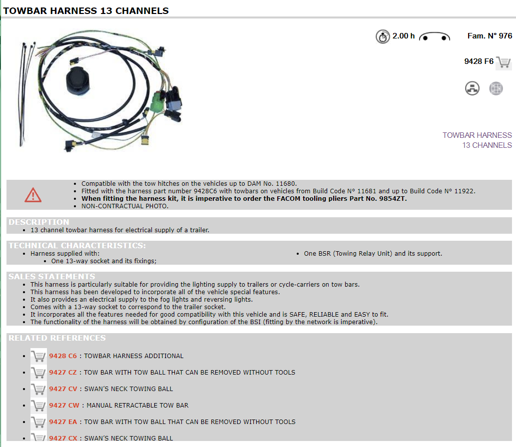

what is the towing ecu module called? this is all i can find out about it: https://matrixqld.com/collections/matri ... 012-1390kg

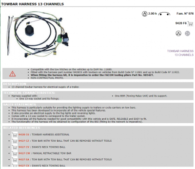

- x 6945
Re: My C5 Woes
This would appear to be the electrics kit, but I would check with the main dealer as to what else you need apart from the towbar - it isn't clear whether the Trailer Fuse Box Unit for the electrics is also needed - I suspect it might, but they should be able to advise you and do the configuration for you if getting it fitted by them.
13-Way Towbar Harness: (Part 9428 F6) - £117.12
