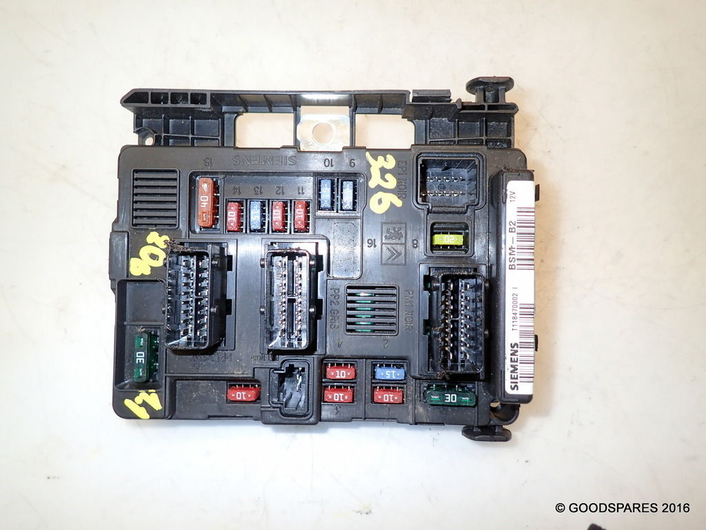

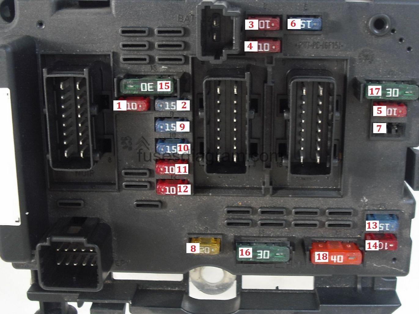

Yesterday which checking fuse continuity using multi-meter, I found Fuse No.1 (in attached) was blown, I joined direct wire but still car did not start.
Anyone has Puegeot 206 petrol (year 2005) fuse diagram stating which fuse number is for what functionality ?
