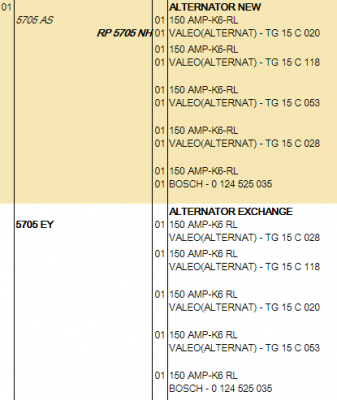

Which of these is a good alternator to get? I've checked service.citroen.com, but there are several different alternators listed.
http://www.mister-auto.co.uk/en/alterna ... 30_g4.html
I was intending on just getting a cost-efficient Valeo unit.
Any recommendations?

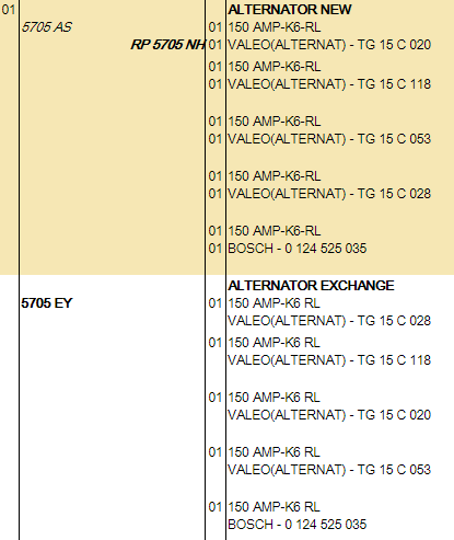

As you probably already know - there are several types (new or exchange):
Best thing to ensure suitability as these are all compatible is to check the numbers / codes on the original. They are all 150 Amp
