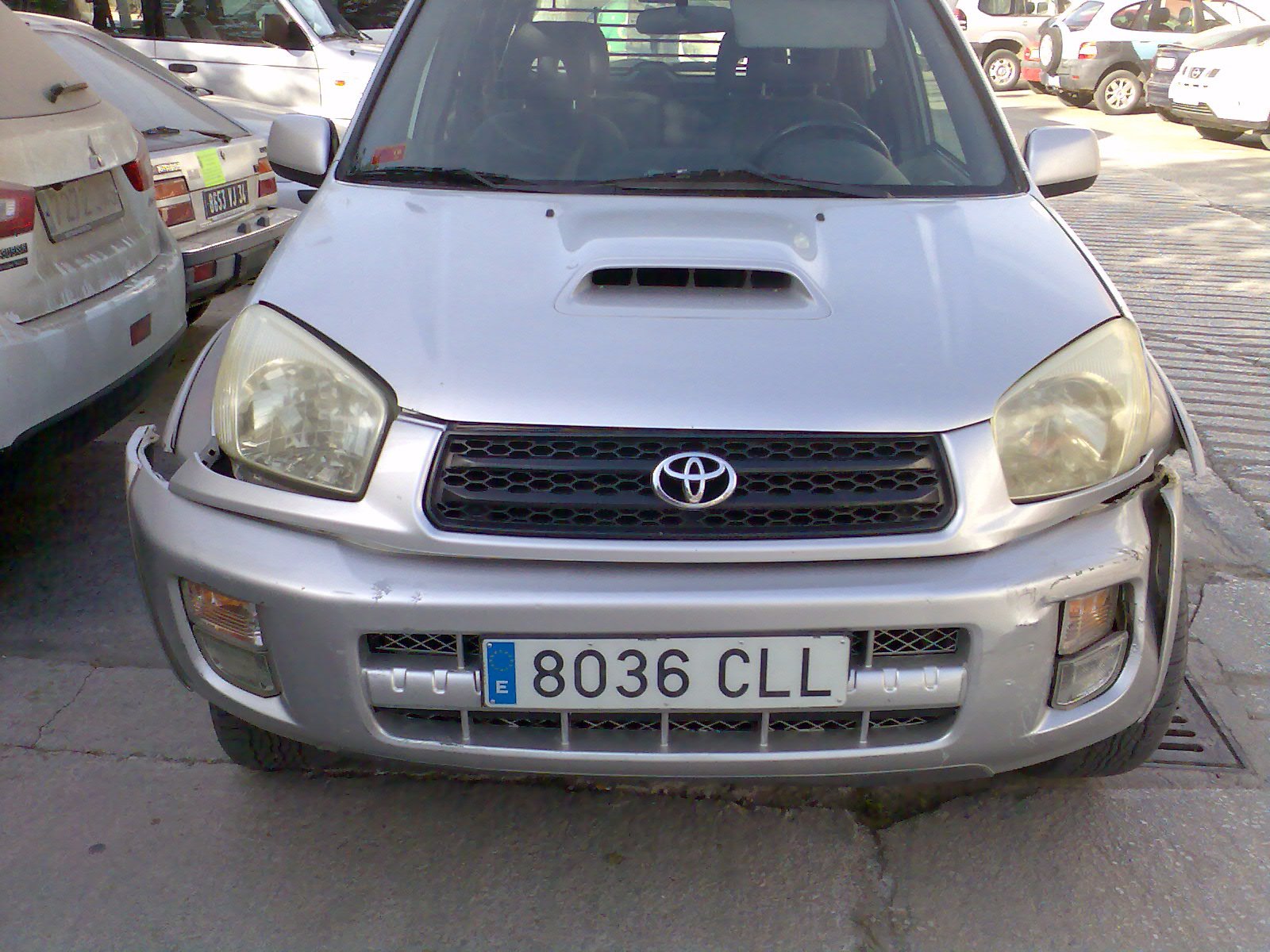

Bit more than just the bumper, Davie: also rad grille surround, wheel arch finishers, upper front cross-member, chipped headlight. Impact knocked the whole lot sideways. Bonnet aok, but everything below it askew. Toyota mechanicals are tough as nails (mostly), but the trim and body panels are 'hung on' by a myriad of hopeless plastic clips and small brackets. Parts prices eye-watering.
Oh well, it's what insurance is for. Loyalty bonus means no Excess. First claim on this vehicle for years, and the very first where it was 'our' fault . . . and I use the word 'our' loosely, if you get my drift. :roll:

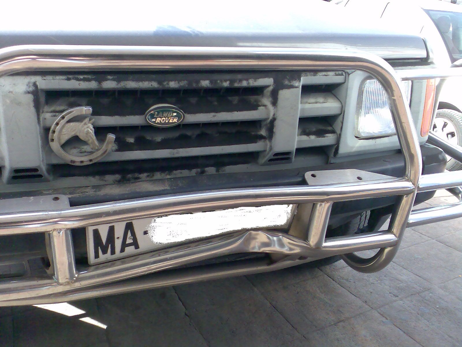

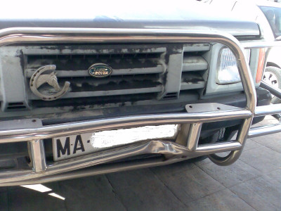

The minor damage to the other one...
Moral: Don't drive Toyotas into Land Rovers, even recent ones. [-X
