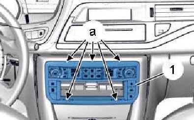

1) Unclip the dual zone air-conditioning front panel assembly (1) ( as "a" ) ; Using a flat plastic Trim removal tool.
Detach the dual zone air-conditioning front panel assembly (1).

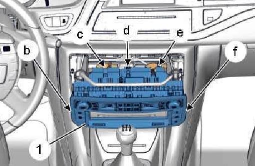

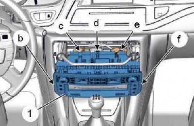

2) Hold the dual zone air-conditioning front panel assembly (1).
Unplug - Release the connectors ( as "b", "c", "d", "e", "f" ).

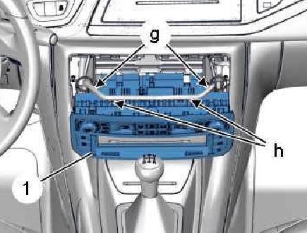

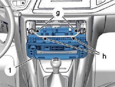

3) Unclip and detach ( as "g", "h" ); Using flat trim tool.
Remove the dual zone air-conditioning front panel assembly (1).

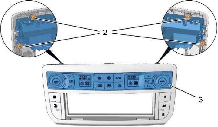

4) Remove The bolts (2), then the dual zone air-conditioning control (3) from the fascia plate.

And those clips that hold the front panel in place ('a' in picture 1) are amazingly tight.
At the risk of sounding like a girl - when I stripped mine I broke a nail.
