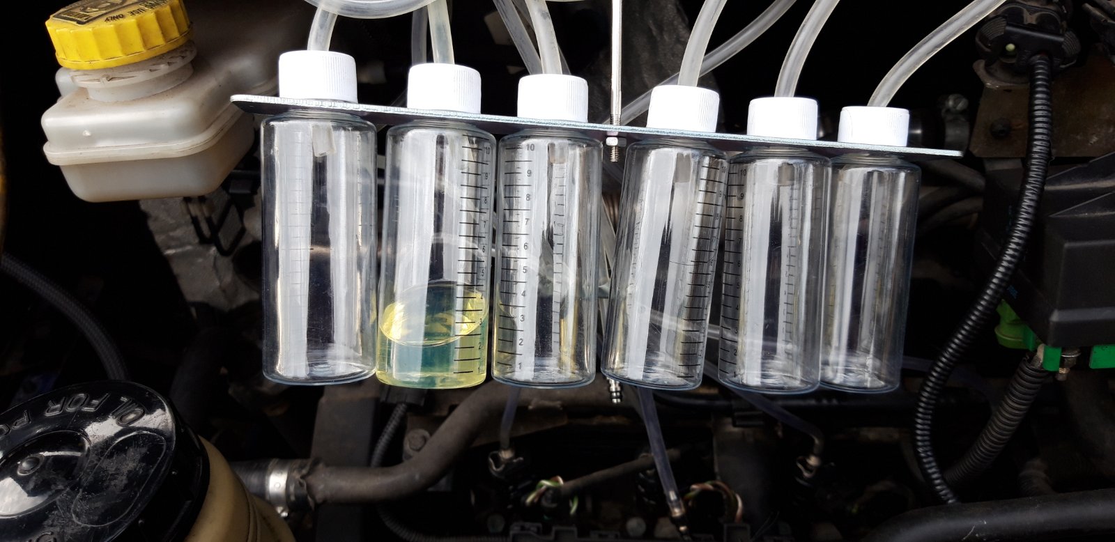

After a bit of a break I started googling a bit more. I read online about a leak off problem so I bought a tester and plumbed it in. This is what I found:
The other injectors were all showing equal amounts of fuel in their their pipes but injector 2 was as shown, so perhaps this was the problem all along and it was just getting worse and worse over time? I've bought another injector, but now I'm struggling to get this one out as it's well and truly seized in there. I've tapped it with a hammer, tried to rotate it, tried to prise it out, and it's still stuck. On the plus side though I think that the tapping it has actually sort of fixed it because in a dessparate attempt to remove the injector I thought I'd try getting the engine warm to see if that helped and after reconnecting all the pipes and electrics I turned the key and it started quicker than it has ever started before. So I think I'm on the right track.
Just need to get the injector out.
I'll be back!
I'll be back!

Wasn't sure what tool I needed to buy to extract the injector so made a tool instead and managed to get it out. It was really rusty and not easy to pull, but at least it's out. Cleaned up the hole, fitted the replacement injector with some copper ease and a new washer, and it started just fine.
Going to give it a bit of a run today but hopefully that's the end of that.
