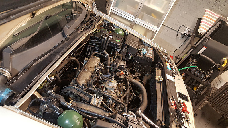

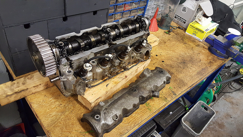

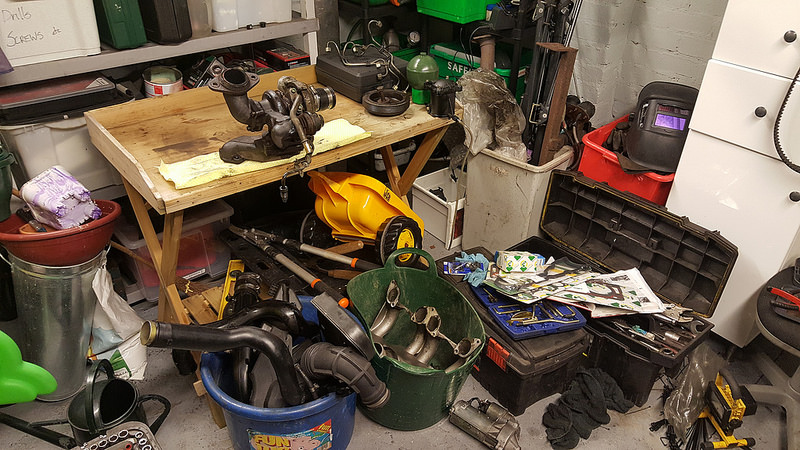

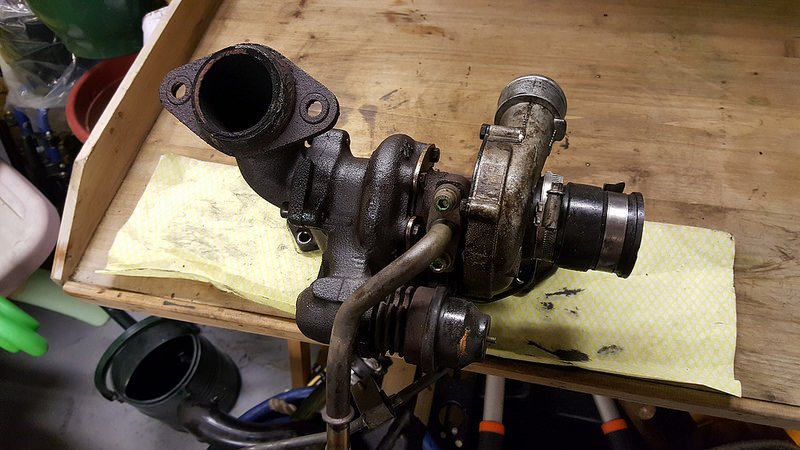

Hi all, I started the work on Friday evening and Saturday everything is off.
In the end I removed all of the exhaust manifold nuts and refitted one to locate lossely, disconnected the exhaust downpipe and the turbo oil pipes and it has allowed the head to come off leaving the turbo and manifold still in the car. I then went ahead and removed the manifold and turbo. You have to remove the engine mount anyway because the lower part has a bolt that goes into the head. So I will take the opportunity to replace the timing belt tensioners that I bought but didn't fit when the TB was done last year.

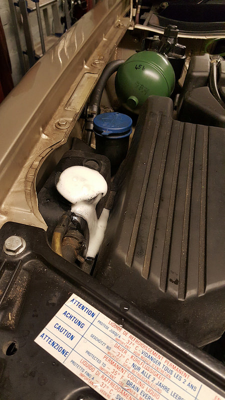

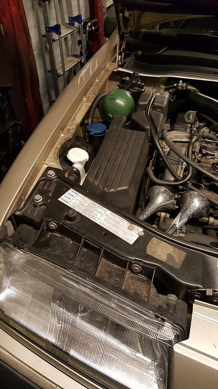

Anyway here's how it began:
20171119_185122 by Graeme McNulty, on Flickr
It was fairly bubbling away..
20171119_185127 by Graeme McNulty, on Flickr
Ran like a dream though
Easy bits off:
20171123_201033 by Graeme McNulty, on Flickr
20171124_164817 by Graeme McNulty, on Flickr
This bit fell off
20171124_223209 by Graeme McNulty, on Flickr
Followed by this bit
20171124_223223 by Graeme McNulty, on Flickr
20171124_223232 by Graeme McNulty, on Flickr

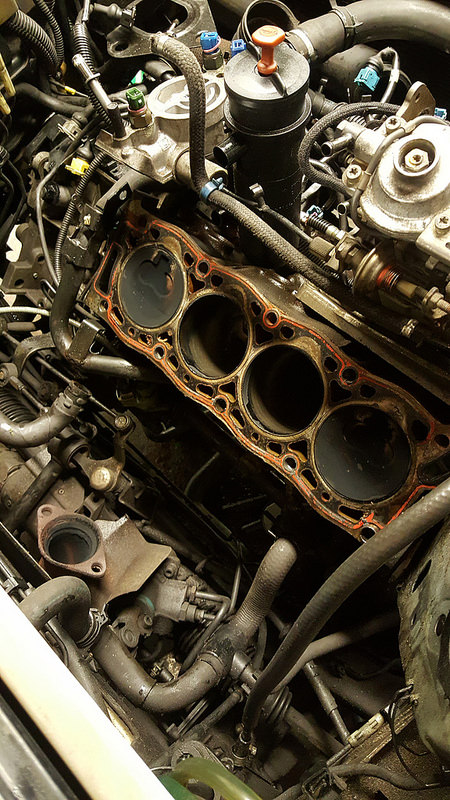

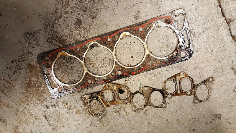

Here's the state of the gasket - not as 'in tatters' as the one that came out of my old XM SEi turbo a few years ago.
20171124_223240 by Graeme McNulty, on Flickr

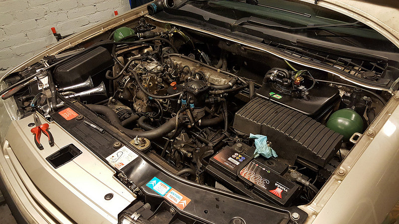

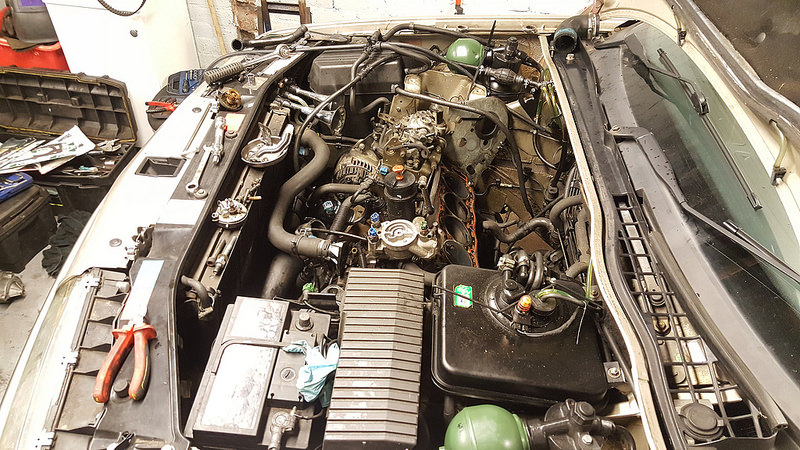

There's quite a lot of space in the engine room now
20171124_223311 by Graeme McNulty, on Flickr
..Might change the steering pinion, gear linkages and the clutch and handbrake cables now that I can just lean in and reach them! Too bad they're all FINE at the time of this job.
20171124_223327 by Graeme McNulty, on Flickr
20171119_185122 by Graeme McNulty, on FlickrIt was fairly bubbling away..
20171119_185127 by Graeme McNulty, on FlickrRan like a dream though

20171124_223232 by Graeme McNulty, on FlickrHere's the state of the gasket - not as 'in tatters' as the one that came out of my old XM SEi turbo a few years ago.
20171124_223240 by Graeme McNulty, on FlickrThere's quite a lot of space in the engine room now
20171124_223311 by Graeme McNulty, on Flickr..Might change the steering pinion, gear linkages and the clutch and handbrake cables now that I can just lean in and reach them! Too bad they're all FINE at the time of this job.
