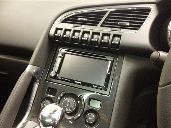

Do you think it is possible, when the problems get worse, to replace the system with a universal double din system ?
![Image]()
The second hand units they are selling on e-Bay are not cheap either and maybe they are also defective.

Be prepared to loose some functions like parking assistance, use of internal telephone, emergency services (possibly - as NG4 may be linked to MDS module) remote steering controls - you have the 3008, so this will be slightly different to the C5 in terms of other display options - but luckily most of the other configuration options are (on the C5) operated via the dashboard multifuction display.
As you are likely to have your phone contact information synchronised over bluetooth with the NG4, you might want to consider a factory reset. Are you on the latest firmware version (42.03 N42c)?
