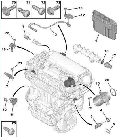

Well for a start, the information was a little ill-advised regarding the Fuel sensor - as this is a 1.4 HDi - so any work on a High Pressure Common Rail system should not be casually approached without a knowledge of the system as the fuel system is obviously under high pressure and therefore potentially dangerous. I'm quite surprised at the RAC for not mentioning that.
In the diagram, part 17 is the High Pressure Fuel Sensor, however, you should also consider the Camshaft position sensor (part number 7). These can also wear and in so doing, can provide weak signals to the injection ECU (Camshaft Position Sensors determine engine position based on the location of the camshaft: engine position is used for determining injection and ignition sequence.)
Ideally, it would be better to have it on a Lexia - possibly with the S.1279 module, as this was a jointly developed vehicle with Fiat and may require the add-on module to properly interrogate the vehicle. Then, an accurate manufacturer - specific fault code can be obtained and troubleshoot the correct component. Replacing sensors can be a waste of money if the correct fault is not identified.

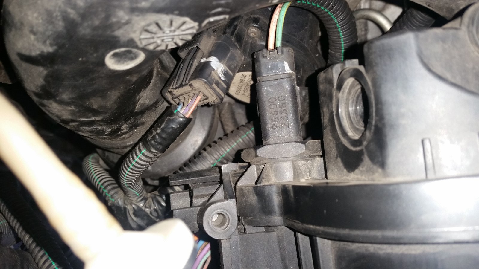

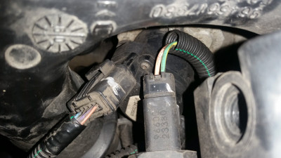

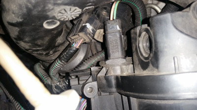

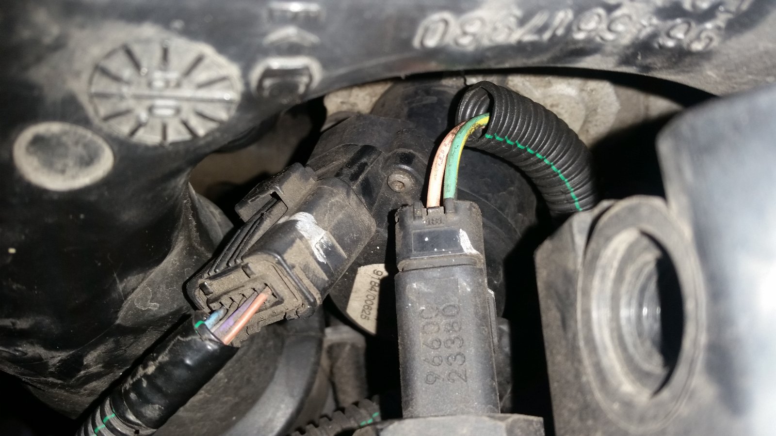

Hi again.
I have followed a video on how to even locate this elusive pressure sensor and I can't find it anywhere.
I removed the battery and battery tray, had a poke around, made sure everything was plugged in that should be and made sure they were solid connections, took a picture or two to see if I was in the right area, but all I seemed to have found is a preheater part. Can anyone tell me where this pressure sensor is in relation to my pics.
The good thing (to me anyway) was that the engine fault light that was off, after a reset by the RAC man has now reappeared and after putting everything back again I managed to get the car started without a hitch, it lasted about 10 minutes and I observed engine revs spike and then the car chugged and died again.

Unread post by RichardW »
It's well hidden under the EGR valve:
However, you need to get some better diagnostics on it before doing anything else!
