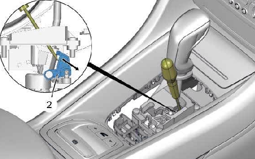

Causes listed are:

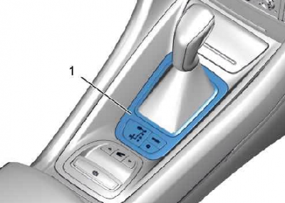

Remove the Surround with a trim removal tool carefully
Unlock the "shift lock" with the aid of a screwdriver - Press on (2) (In the direction of the arrow ).
Move the selector lever to disengage it from the "P" position.
I can't see a separate part listed for this bit separately though... so try and get a little grease on there if poss.

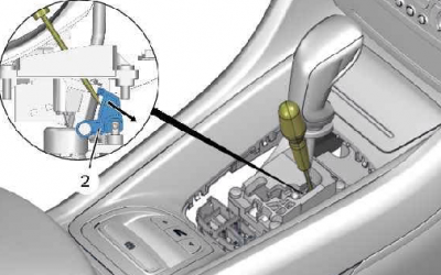

Causes listed are:
- The battery voltage
- The "shift lock"
- The selector lever position switch
- The automatic gearbox ECU
- The wiring harness
