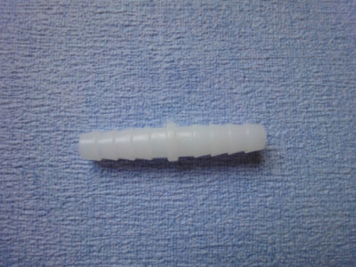

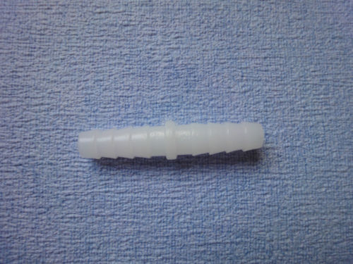

Rather than replace the whole (broken!) corrugated pipe on my '09's rear washer, I looked for a simpler way of doing it....and found one! :) I bought one of these
from the local motor factor for 50p - its a 4mm one. I bet you know what I did with it! :lol: Its a really tight fit into each end of the broken original pipe. I put a little bit of bathroom sealant around the join too - job done, works perfectly, no leaks at all! :-D
