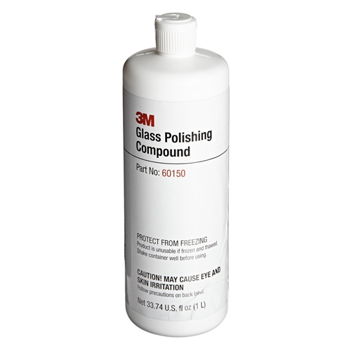

I doubt T-Cut and Windolene would be man enough for the job. You would also need the power buffing tools or similar shown in the video.

The key is doing it in stages - deep enough to cut the scratches then lowering the pad abrasiveness to get that glass like finish back so you don't end up with worse swirl marks - or that will be a killer in the strong sunlight / night headlamp glare. Great if you have the polishing tool, the pads / discs, compound etc. already to hand. I do, but don't trust my skills at using it effectively and didn't want to make it worse - so said sod it - for £90 I'll have a brand new one, ta muchly.

Looking on a well-known auction site and finding the price was an eye-watering £40 - £50 gave me pause for thought. And that was for a litre as well. I know a ZX screen is quite large, but that much polishing stuff is overkill.

Windowlene has "glass" in it ?
The 3m stuff is a "breakdown" abrasive.....£40 is less than the cost of a new screen.
