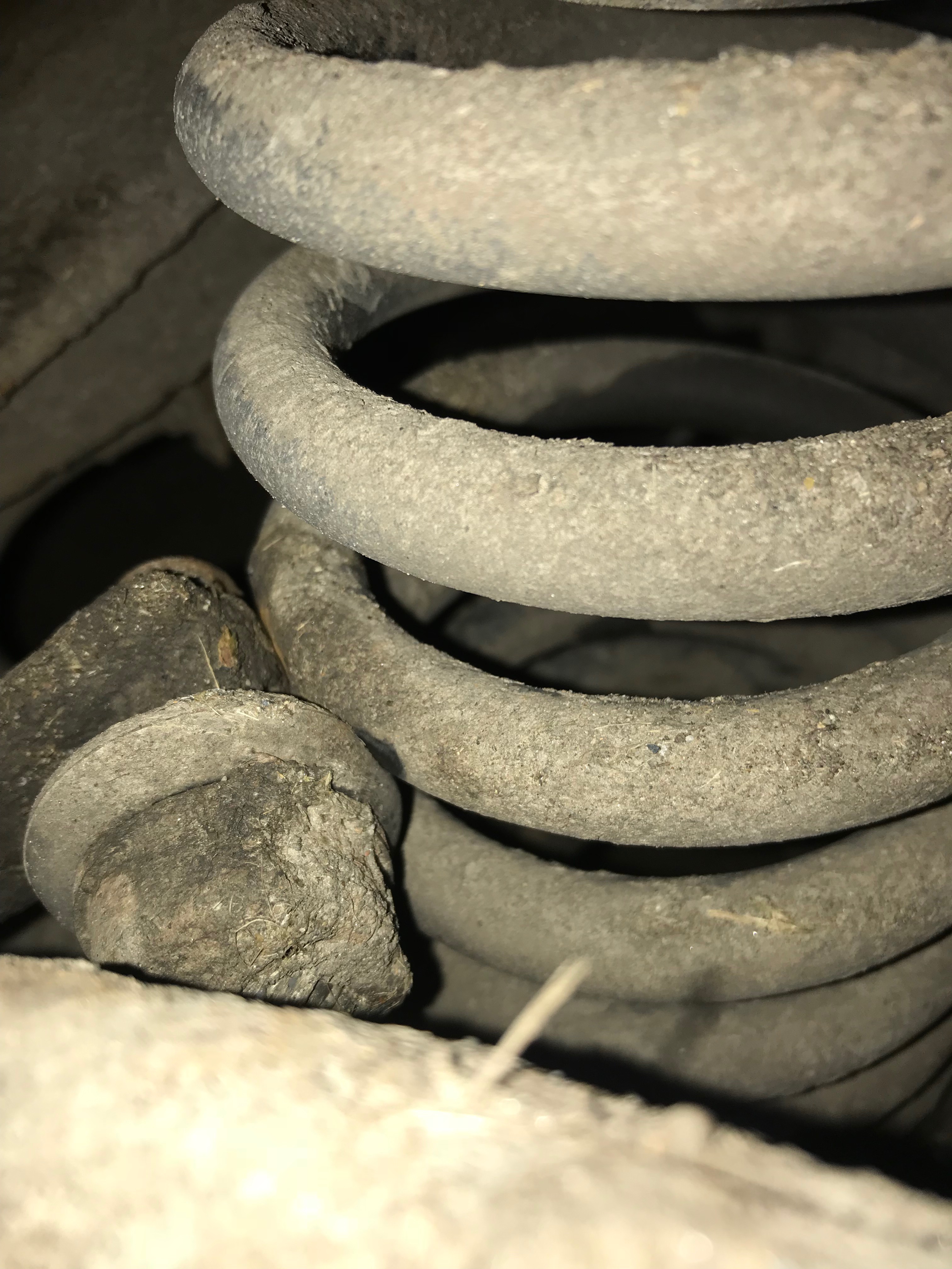

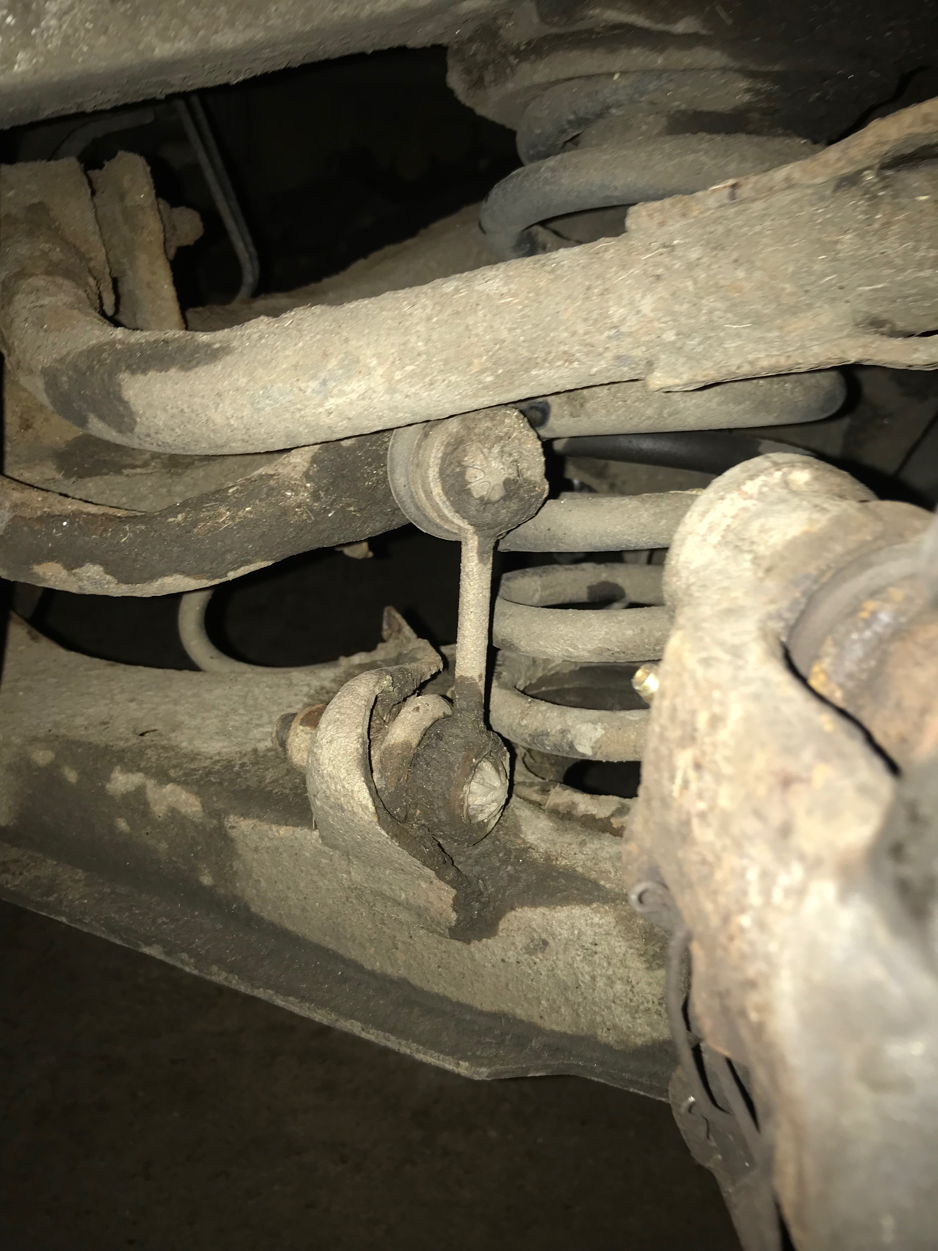

My 607 failed its mot recently, the rear passenger side droplink was hitting the coil spring. Something i didnt notice on the lift but with the car on the ground and a jack pushing the hub up i can see the link is hitting the spring:
On the other side there is much more clearance between the spring and the anti roll bar.
I cant see any play in any components of the back axle, the anti roll bar is in place quite securely, the hubs on both sides seem to measure equal distances from the arches.

Can you just push the anti-roll bar across to centralise it?

Regarding the clearances, i think its the rear coil spring on the passenger side it has 'bowed' if that is the correct term, the middle of the spring is leaning towards the front of the car, the spring on the drivers car is still straight. It might be curable by rotating the spring or replacing it. The only issue is this may require spring compressor that clamps through the middle of the spring.
