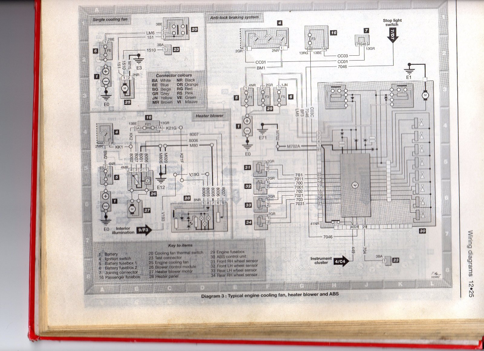

Right, the transistors should arrive today. I want to do the relay mod whilst I'm in there. Been checking all the posts but they are related to the Xantia and the wiring is slightly different. Could someone confirm what I'm about to do is correct please? In the Haynes BOLs is says wire KK! comes out the ignition then splits in to two, one going to the passenger fusebox (fuse 21) the other going to connector 4 om the module . This would be the correct wire to cut and use for the relay signal, using connector 2 wire as the relay earth? Then splice into the red wire that feeds the ignition from fuse 2 (battery fuse box 1) and send that through the relay and join it the the wire going to connector 4 (the other half of the wire previously cut) By using the above method of cutting and splicing, the new heavy duty motor feed is using the original fuse that protected the circuit (fuse 2), so I wouldn't need to add an inline fuse?
Would this be the right way of going about it?
Confirmation or criticism and corrections greatly received.
Thanks .

Updated with a scan of the BOL's to assist any gurus that didn't ave access to the 406 book.
Thanks

Not had chance to do the relay mod, so I've left the cowling off for the moment. Can anyone confirm my wiring idea above please? The colour coding is different to the Xantia thread and a lot of the links don't work due to them being posted 10 or so years ago.
Thanks
