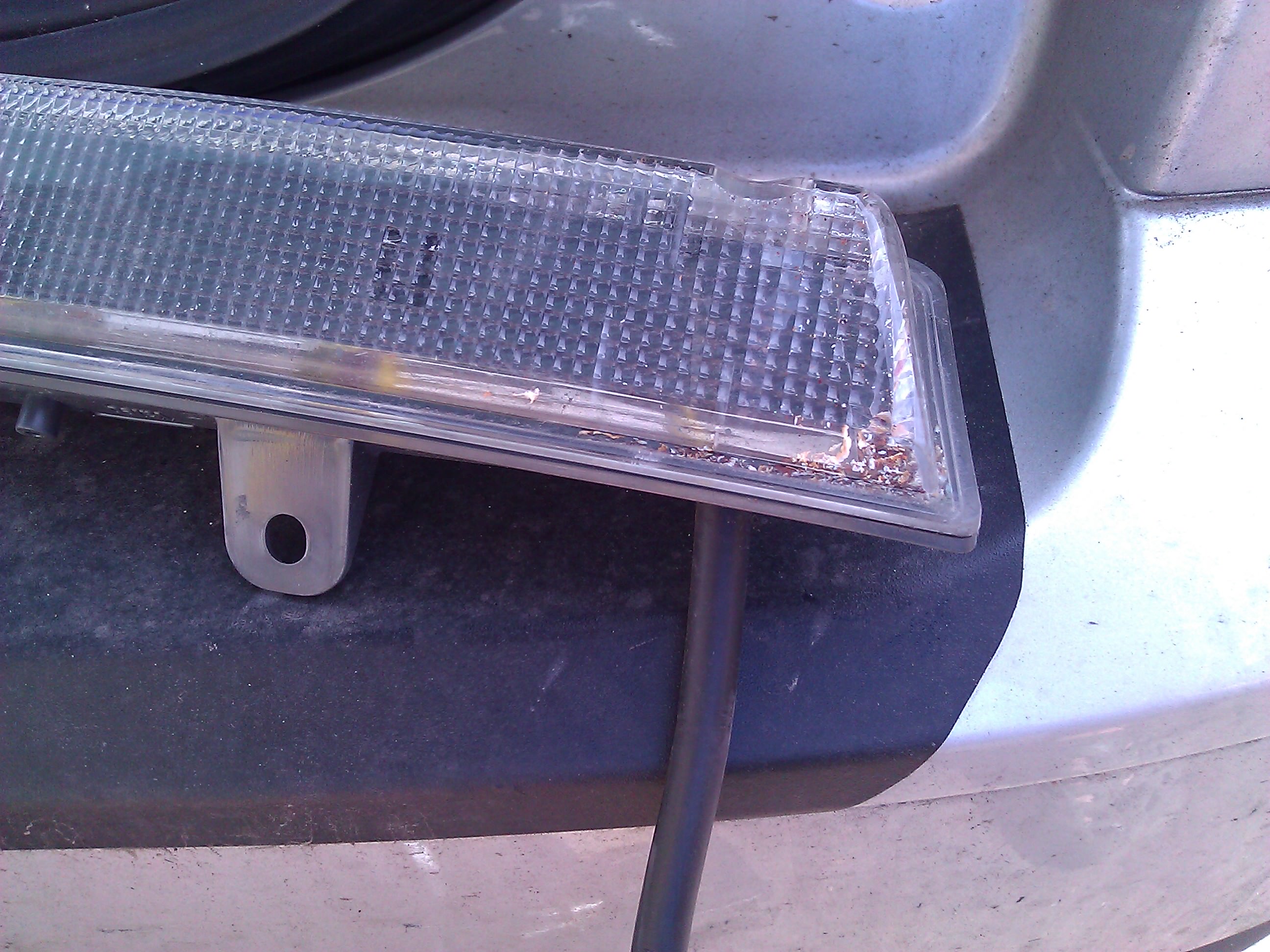

The LEDs are not bulbs as such, they are chips on a flat printed circuit board. As soon as I got power reliably to the PCB the LEDs all lit up properly. I'm guessing all are the same, suppose they might have used different suppliers.
You can open up the unit by sliding a thin blade between the transparent bit and the black
moulded body, and re fix with glue or sealant. Once in, you wiggle the PCB up, maybe a couple of screws, don't re call, you will see it sits on two prongs which are the conductors. It was that area where I had corrosion, yours might be different but for the sake of half an hour fiddling you might save £100, nothing to lose. Remember polarity matters with LEDs.

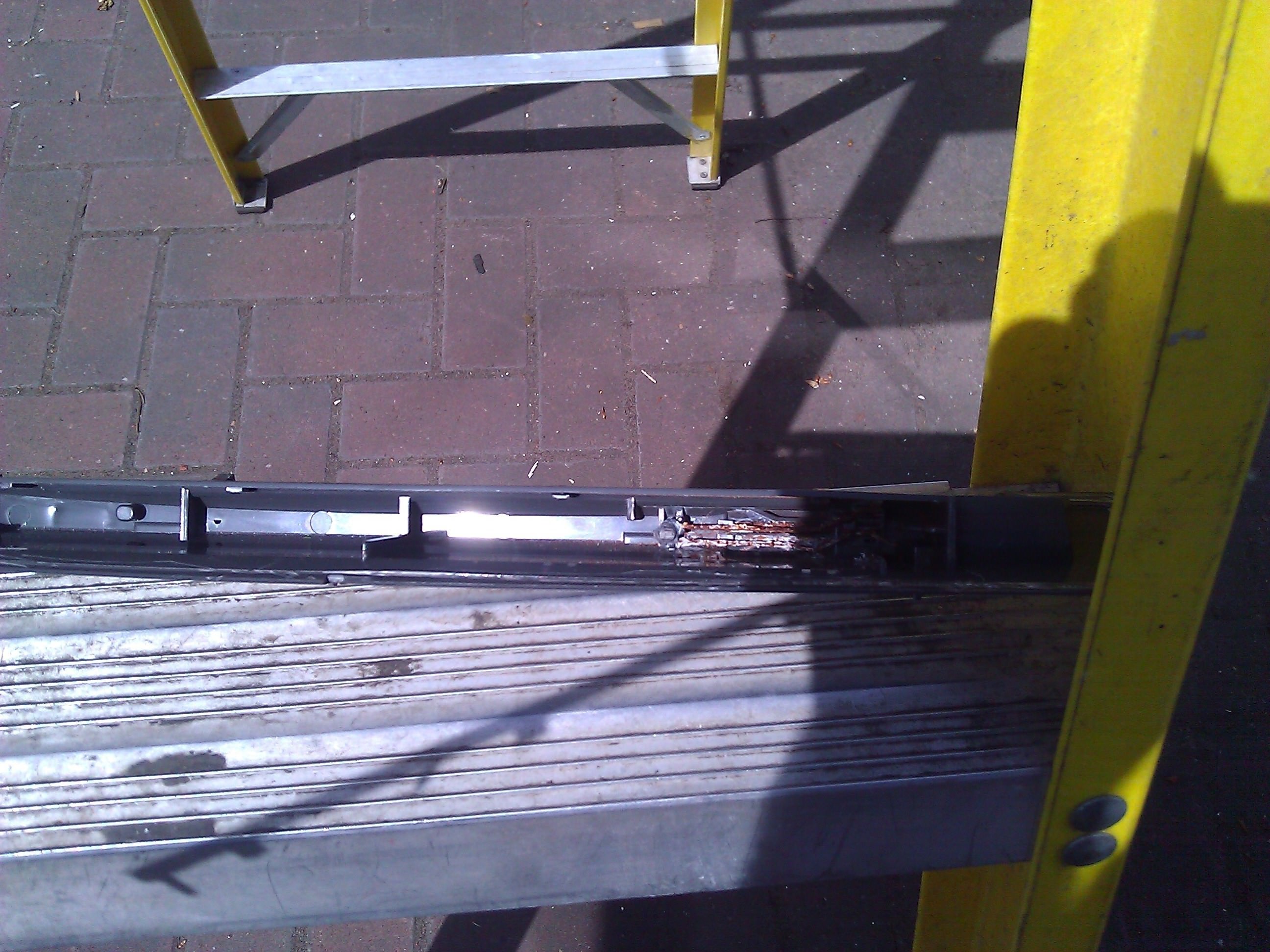

from memory of doing mine..a long time ag....pretty sure it's a 'motherboard' jobbie?
mine had rust at bottom lense, connecting pins were corroded to the point of being non existent, soldered wires to board and ran them long enough to connect to loom.
it is i think a 'sealed' unit as such but took mine apart and resealed, probably better than OEM and had nothing to lose if it failed.

If you see something like this....
then the connecting pins will be something like this....

Yes that's what I did, even after clean up.it wasn't reliable so soldered a lead directly to PCB, plenty of space, drilled small hole for lead and sealed with gloop, ran lead a long way back to bypass a connector or two.
