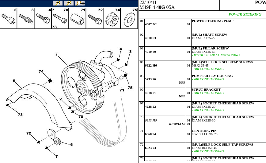

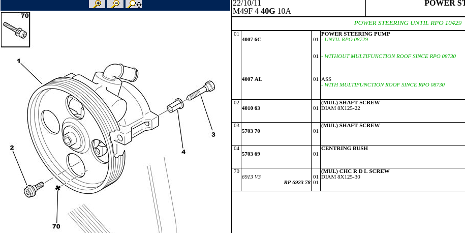

I've given ServiceBox a check.
DW8 PAS Pump part number: 4007 6C
XUD9 PAS Pump part number: 4007 5C
Tantalisingly similar.
Reckon it's worth a go?
DW8 1.9D PAS Pump:
XUD9 1.9D PAS Pump:
