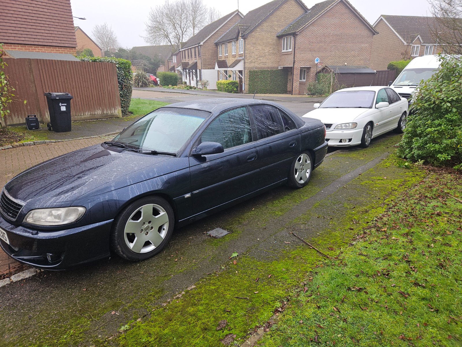

I've been doing some delivery work in my spare time, it's actually quite good fun as it's not my main source of income.
Here's a few pics of the stuff I've spotted on the rounds..

Michel wrote: 28 Dec 2024, 18:26 I've been doing some delivery work in my spare time, it's actually quite good fun as it's not my main source of income.
It's amazing what you see doing that sort of thing Mike; I get to see a good few when out running...
