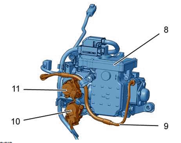

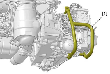

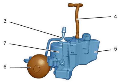

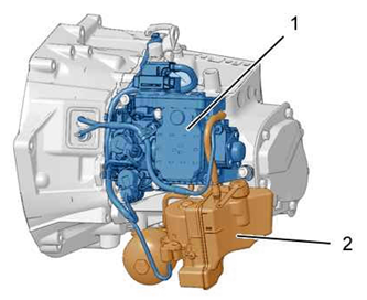

Here are some pics of the main components:
Actuator (Electro-hydraulics & Electro-pump) Actuator Electro-pump detail
(3) High pressure hose.
(4) Reservoir return pipe.
(5) Hydraulic reservoir for piloted manual gearbox.
(6) Pressure accumulator.
(7) Actuator electro-pump unit electric motor. Actuator Electro-hydraulics
(8) Piloted manual gearbox ECU.
(9) Decluch piping.
(10) Gear engagement position sensor.

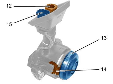

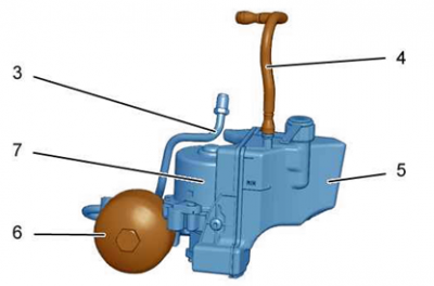

(11) Gear selection position sensor. Declutch Unit
(12) Hydraulic piping union.
(13) Declutch bearing.
(14) Travel sensor.
(15) Electrical connector. System 'in Situ'
