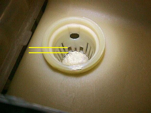

First the suspension should be checked on the lowest setting. Leave the engine running for 2 minutes. The level should be between the yellow lines in the picture.
Yes it is fine to remove the cap and no you won’t have to repressurise the system unless it is empty and needs completely refilling.

GiveMeABreak wrote: 03 Nov 2017, 00:55 First the suspension should be checked on the lowest setting. Leave the engine running for 2 minutes. The level should be between the yellow lines in the picture.
Check under the car in the morning to see if there has been any fluid leaking onto the ground. You might of nicked a pipe down the track.
Good morning a warm sunny day here.
Thank you for the details and the image. : )

EDC5 wrote: 03 Nov 2017, 13:30 Should the level be checked on lowest setting or depressurised?
I ask because on Lexia under the 'Delivery' section the 'check suspension fluid level' option proceeds to depressurise the suspension and then asks the operator to disconnect the battery.
The levels can be checked without using Lexia / Diagbox to depressurise the system - for a ball part guess, but important to leave the car running on low for about 2 minutes just to allow as much fluid back into the reservoir as possible. They have to allow customers to check and top up the levels without expecting them to have a Lexia.
@ Spiff: I had to 'poach' that image from the web as I was out in a coffee bar with no access to my images - but purpose served

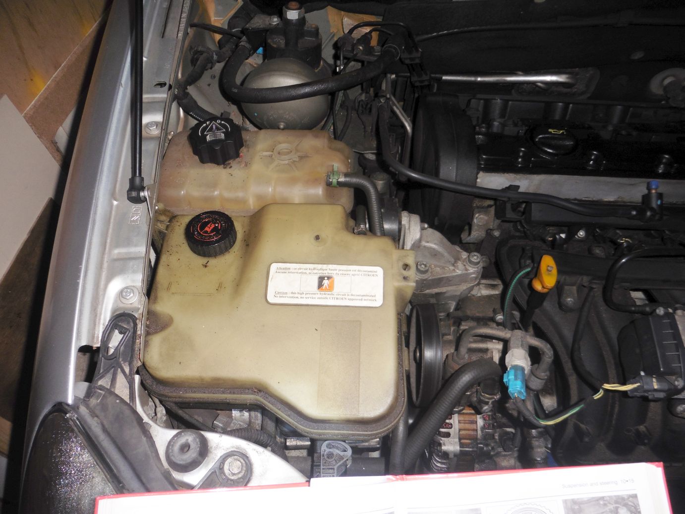

Pump ran as I got in car, I dropped it to low and ran engine for two minutes, the level is correct as per image : )
Replaced cap and ran car up to max height then back down to normal, all OK.
