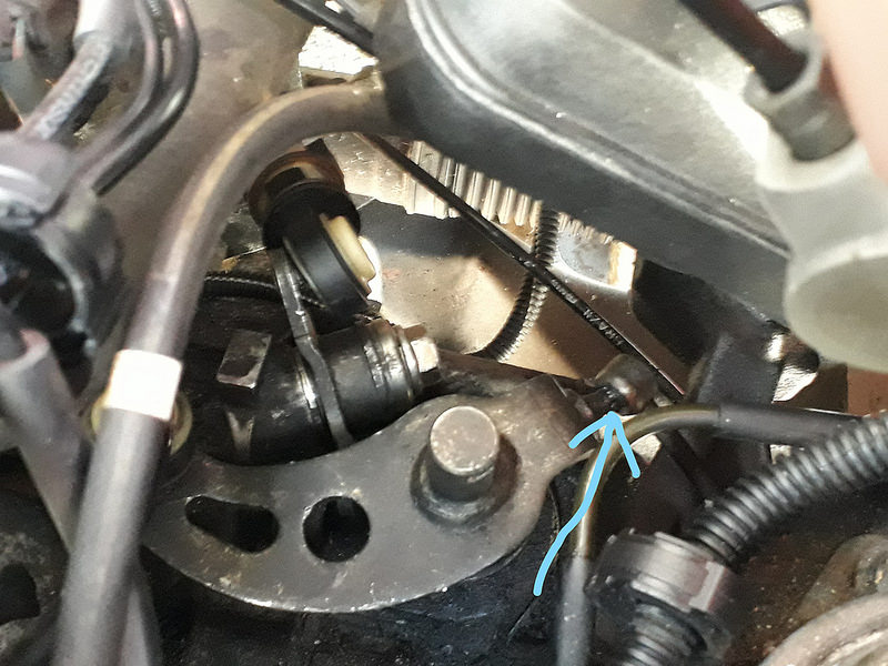

Odd related Q...
On the end of the selection arm is a short ball and socket rod that seems to go down to the mount. What is it's actual purpose? it doesn't appear to do anything other than anchor the arm.

Re: ML5 Gearbox/selector/gears
That's a new one on me... Normally there is what looks like a counterweight in the position indicated...
What's on the other end of that rod exactly?
The counterweight is there (follow the arrow further and you'll see it). The other side is where the cable connects for the horizontal movement of the arm (ie fwd back on the stick).
